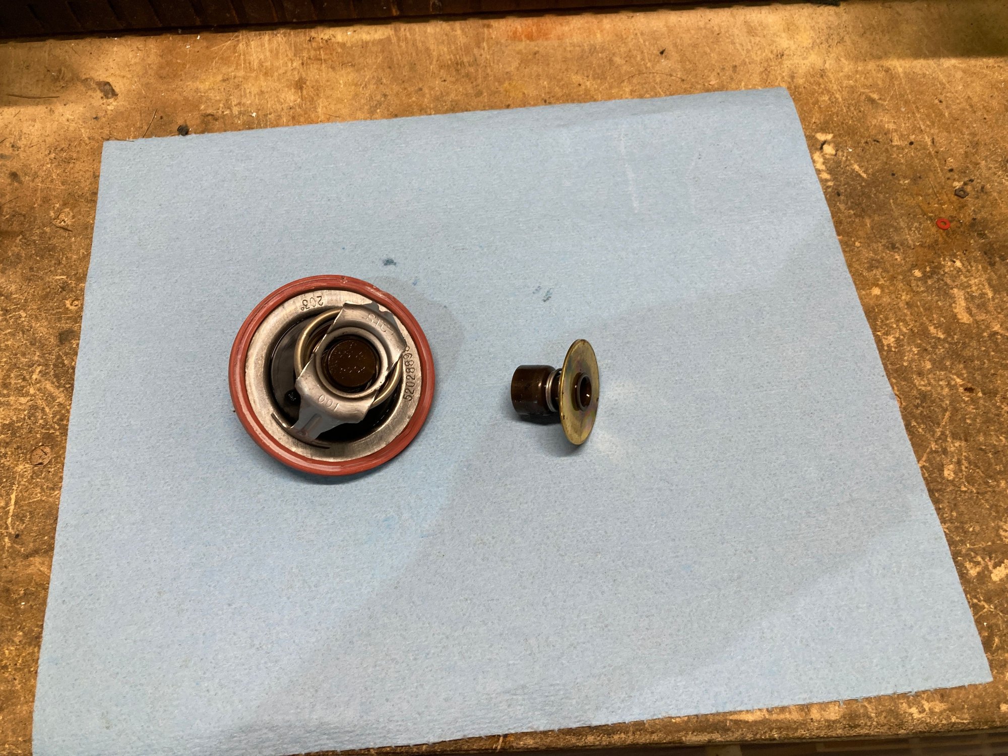

Here's the update. The dealer said the truck was "operating normally". I don't tend to think the temp gauge moving all over the place is normal and I asked them to please replace the thermostat under the lifetime warranty but they refused. It's really frustrating when I've driven this truck almost every day for 14 years and I know what the temp gauge does but a guy there can't find a code and drives it for 5 minutes and wants to tell me everything is normal. The temp gauge was erratic on the drive home from the dealer, so nothing had changed.
In any case, I replaced the thermostat myself with an OEM one and it seems to have fixed the problem. The temp gauge now sits just below the 1/2 mark and doesn't move any more than the width of the pointer. The old one came out in 2 pieces. Picture attached. The loose piece will pop back in and stay in place but I don't know if it's supposed to be able to come apart like that.
I'm going to ask the dealer to refund my money for the thermostat, that should have been on them. I imagine they'll balk, but it's worth an ask.
