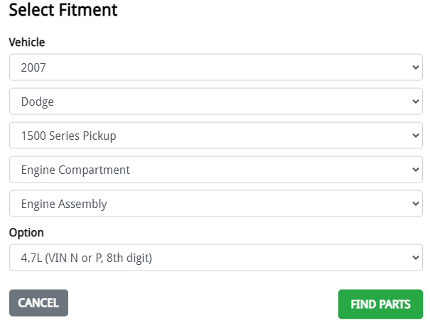

hello? I am a person living in Korea. While my father is in the hospital, I want to repair the engine of my father's ram vehicle, but it looks like the engine needs to be replaced.
I want to buy a used engine in the US and do an engine swap.
I have a question, my father's car is a 2008 model, is it ok to buy a used 2007 engine? There's a lot of price difference.
We will write a picture of the vehicle and part of the VIN code.

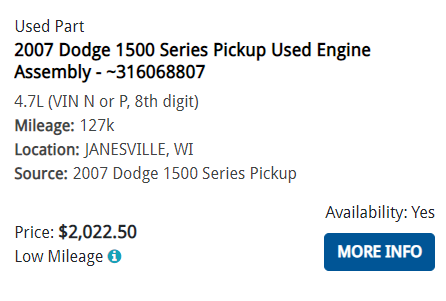

The car is 2008 DODGE RAM 1500 ST QUAD CAB 4X2 with semi hemi 4.7 engine. Since there are not many 4.7 engines, it is difficult to find information, so I inevitably ask a question. Also, below is the content written in the sale article that is being considered for buying used "Used"
Engine Assembly BOTH VALVE COVERS NG,UTR, XTHB, 4.7L, VIN P (8TH DIGIT)
Part No:~316068807"
I would like to purchase these 2007 4.7 engines, please help.

Probably not. Quite a bit changed from 2007 to 2008.... dual plugs, higher compression, etc.

No, if it's a 2008 4.7 you have to find a 2008 to 2013 4.7 engine to replace it.
