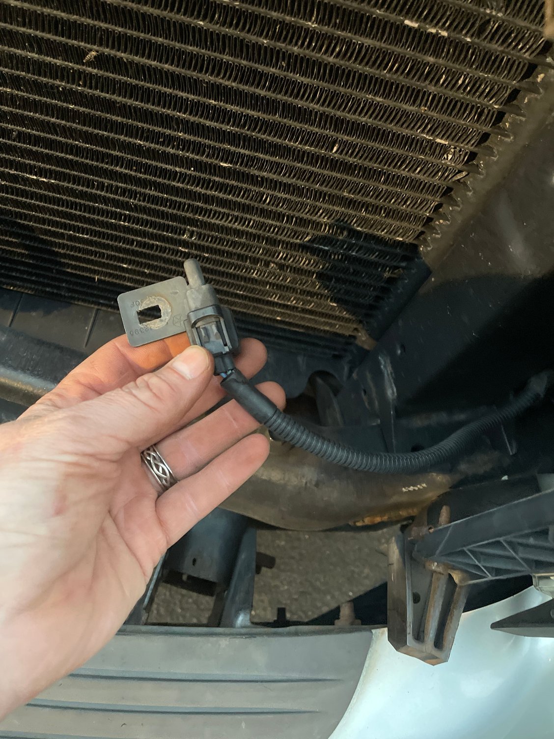

Found this hanging don’t know where it’s supposed to go or even what it is.
This is on the drivers side front of the car. Any and all help is much appreciated.

Probably ambient temp sensor.

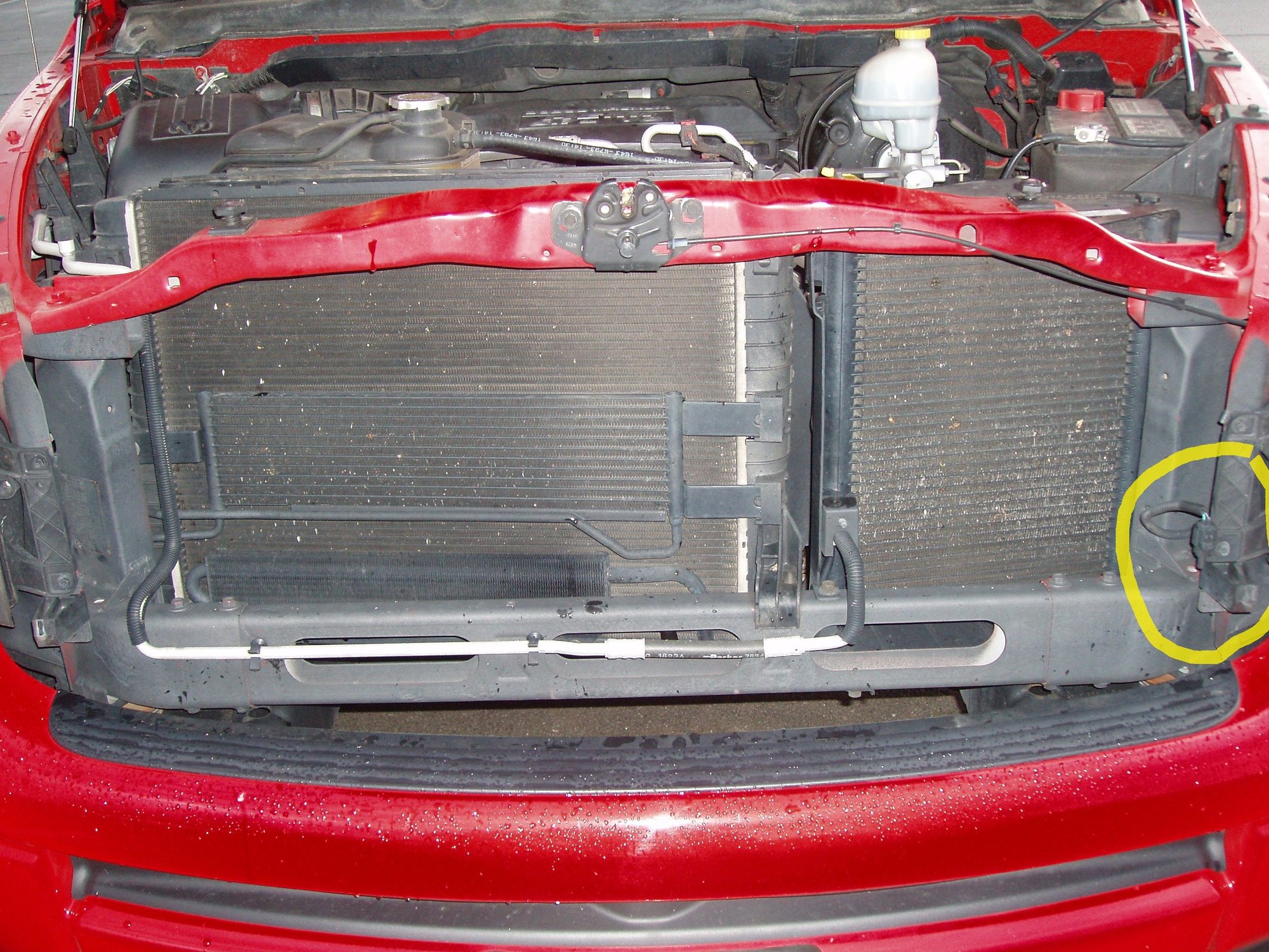

Ambient temp sensor, should be on your headlight:
