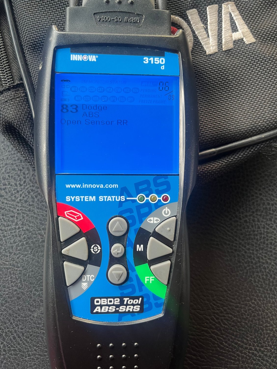

Hello All,
I've search the forums form my issue but could not find an appropriate answer. I was wondering if there may be some techs that may understand my issue and guide me in the right direction.... I purchased an 02 Ram a few weeks ago. The speedometer did not work, it had a blinking ABS light, and brake light. so I did some research and it turns out it was the ABS module. My module however has been discontinued by dodge and it took me a while to find one through the Cardone site. I paid $400 for it and replaced the old one. Now my speedometer works and the brake light turned off but my ABS light is blinking and a chime accompanies it. I have an ABS scanner and tried clearing codes but did not work. By the way, I think I must mention that this module is a 2 wheel ABS module and that one of the ABS codes says its missing a sensor but my truck only has one ABS Sensor and that is the one on top of the differential. Has anyone ran into this issue? My OE module part number is 52010035D. Thanks for any assistance

What scanner are you using? I did some research but did not find any scanner compatible with 02-05 RAMs.
Also you might check your sensors maybe? Do they all give a signal? The 2-way ABS has 2 sensors I think. One in the front and one in the back?

This is the scanner. It is saying the RR sensor is open and front left. I checked the hubs but there are no sensors going to the hubs... ??
