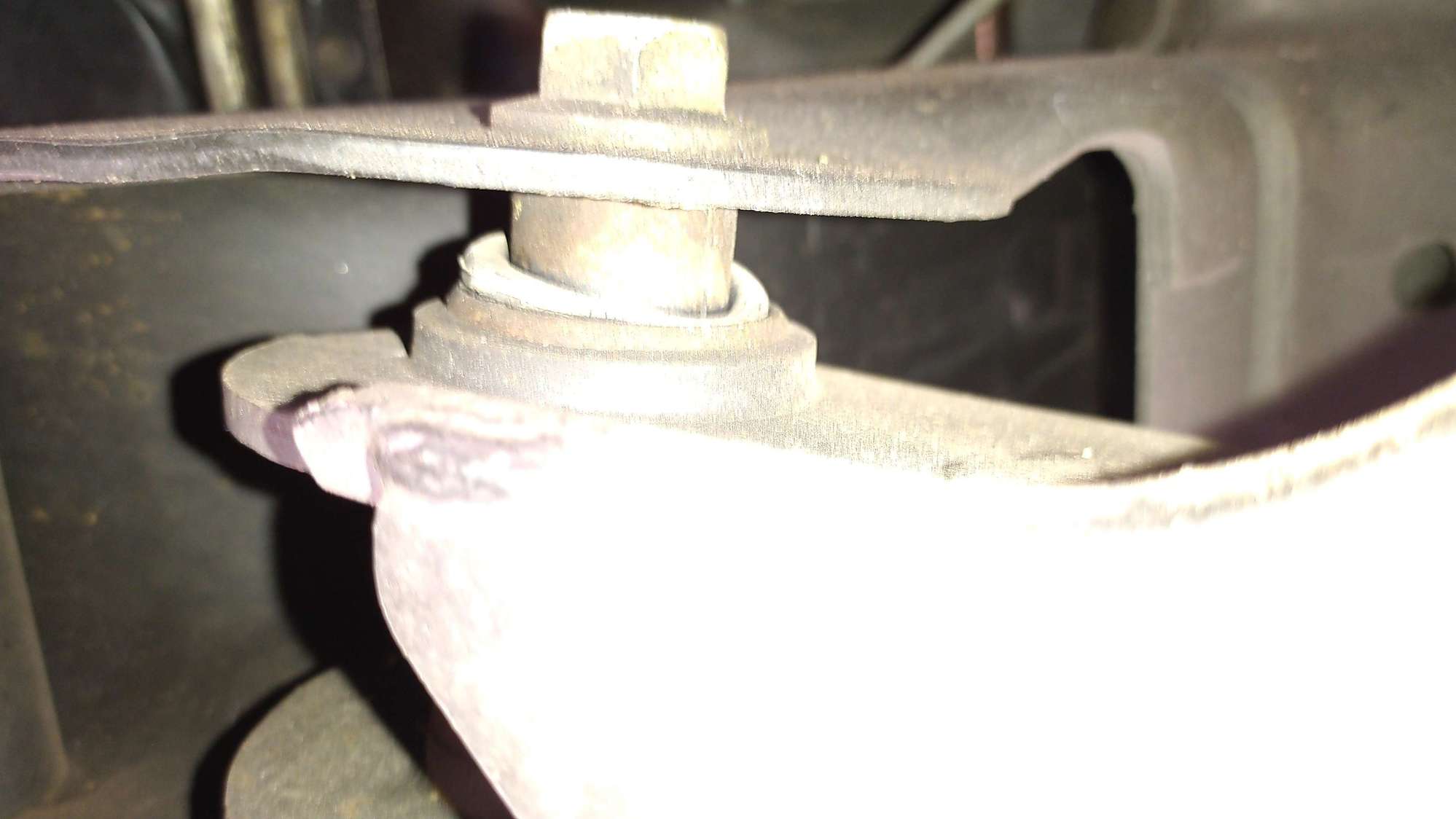

The brake caliper slide pins and the metal sleeves they go through are pretty much perfect, I checked them when I was working on the front end and greased them. I jacked up the front end once again and really shook the wheels hard and when I shake the passenger wheel from top to bottom really hard (I mean rocking the truck just about) I feel a barely perceptible amount of movement, although I don't think it's the ball joints because they're still brand new and greased. I decided to slide underneath with a pry bar and check everything including the steering rack to see if anything moved and I couldn't get anything to move. The only thing that looked out of place is that on the passenger side one of these bushings looks sorta pinched? Couldn't get it to move though. Maybe I should just replace them anyway...
