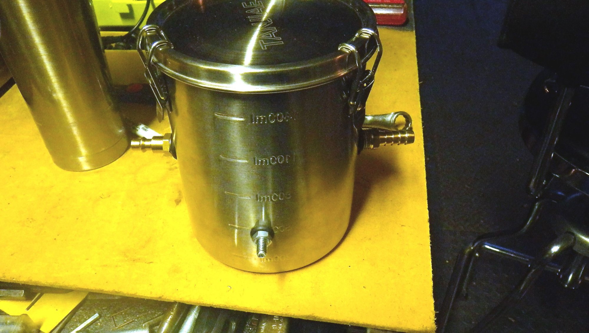

I can't see inside real well, what are the electrical connectors for? You have a hot wire in there to keep things burnin?

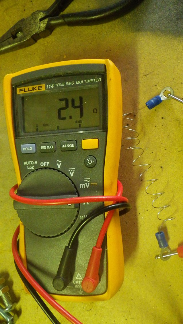

Sorry, it's MINERAL OIL not mineral spirits!
It's resistance wire. 2.3-2,4 ohms wrapped around the wick. Soak the wick with MINERAL OIL then let the wick ends lay in the MINERAL OIL. Using a 12-volt auto battery for supply.

OK, that makes much more sense to me. Thank you.
What pressure do you run your air at?

3-5 psi
