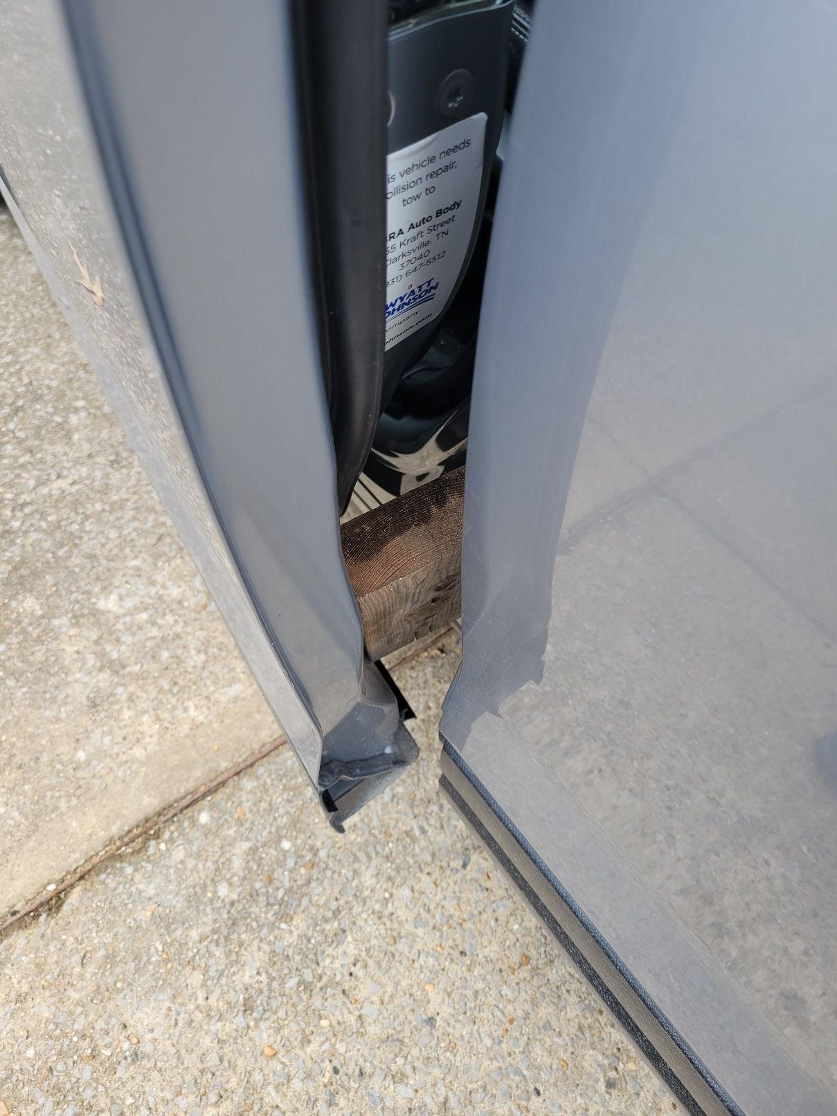

With the door shut is the upper right corner not tight? When viewing from the outside. Different vehicle but I tried the knee method and couldn't get enough leverage. Used a block of wood and pushed from the outside.
