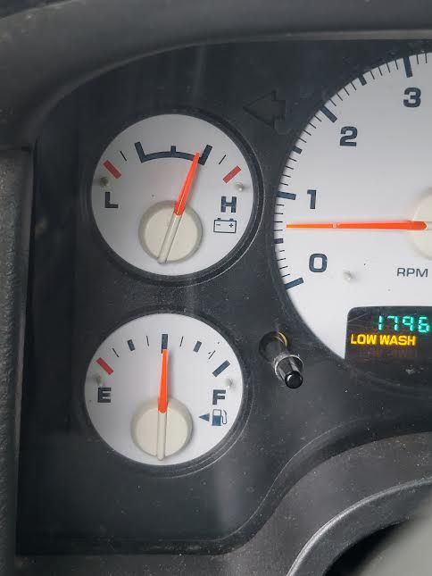

I had the battery tested at Napa and it is in good working condition. I also swapped out the fuse box today with one that had been sitting around. The problem with that is if it was switched out before than there is a problem with it. But my thought was if it runs it's more than I have now. And it did. But what's strange to me is sometimes the truck will start several times in a row drive perfectly and then when I drive it and get home and turn it off and then go to restart it, it is completely dead with the exception of the anti theft light pulsating and sounding like a squeaky door hinge. This light goes off when the key is turned.
So I take off the battery cables for a couple of minutes, put them back on the terminals and it starts up. I always know when I am reconnecting the cables to the terminals if it is going to start because I will see and hear small sparks. I would have interpreted the volt gauge being high to be a sign of a bad battery but the battery is good. When the truck starts, it runs fine. I would have interpreted the high reading on the voltage gauge to be a sign of a bad battery but I don't think so. When I connect a multimeter to the battery while the truck is running it reads around 14.56. If this makes any sense I love to hear it! Thanks!!
Old Apr 17, 2024 | 07:47 PM
Posts: 87,479
Still sounds like a bad connection at the battery to me..... (or, at the TIPM)
