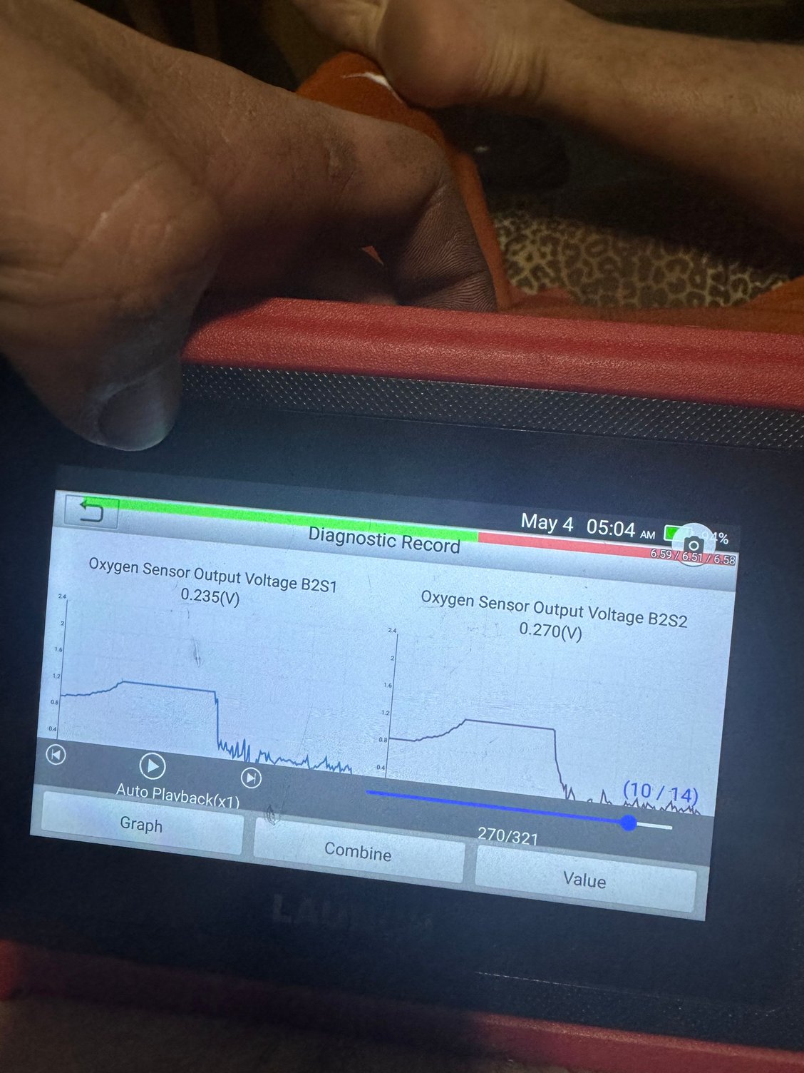

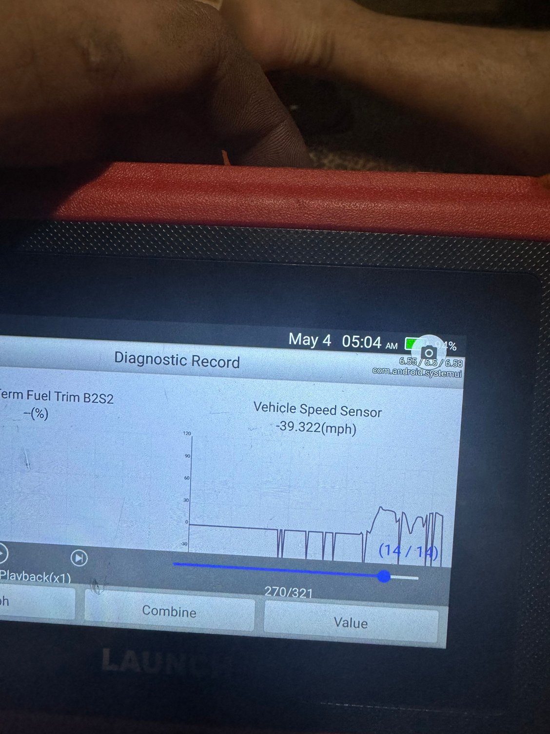

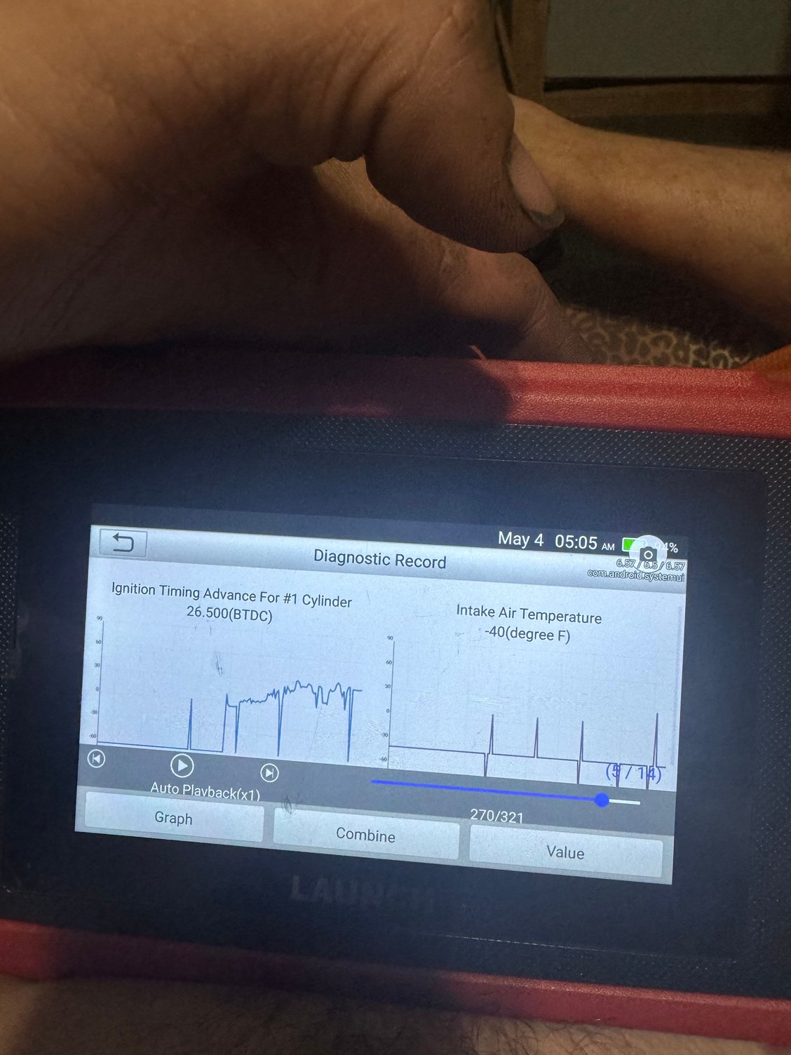

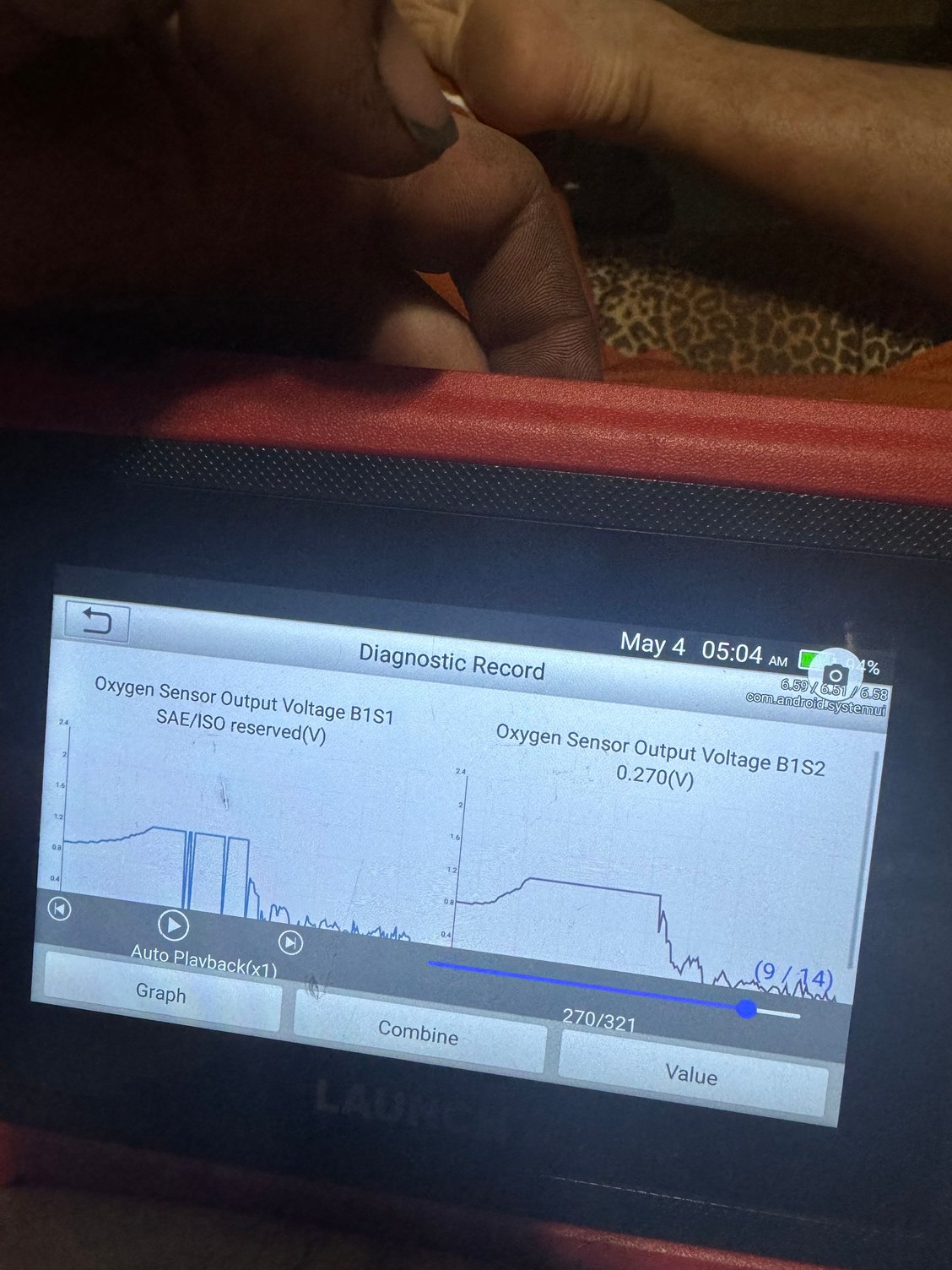

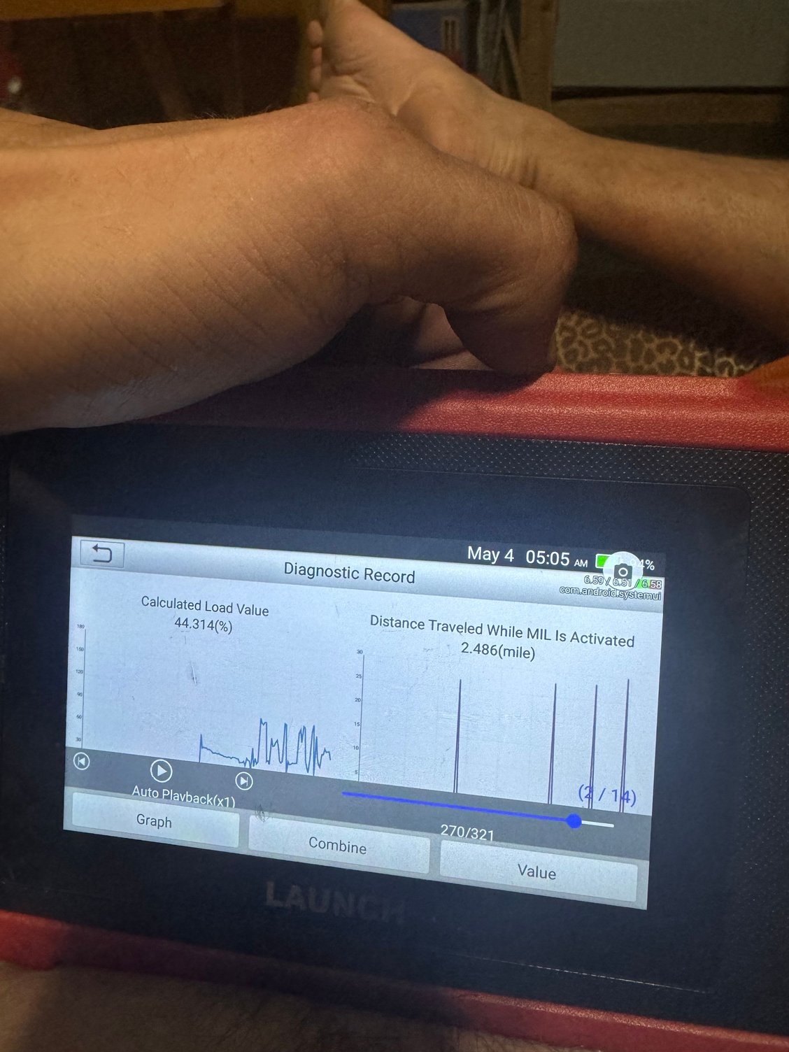

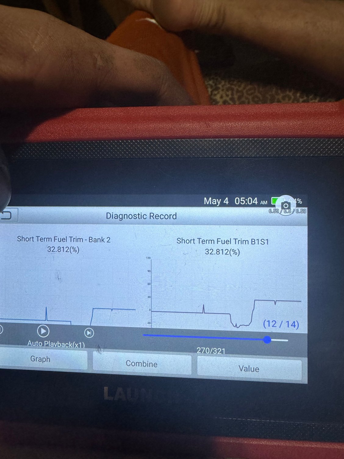

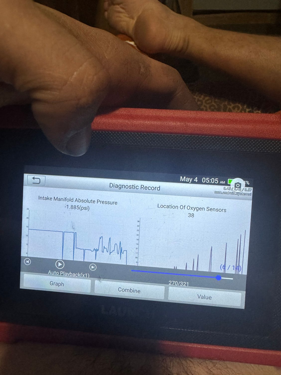

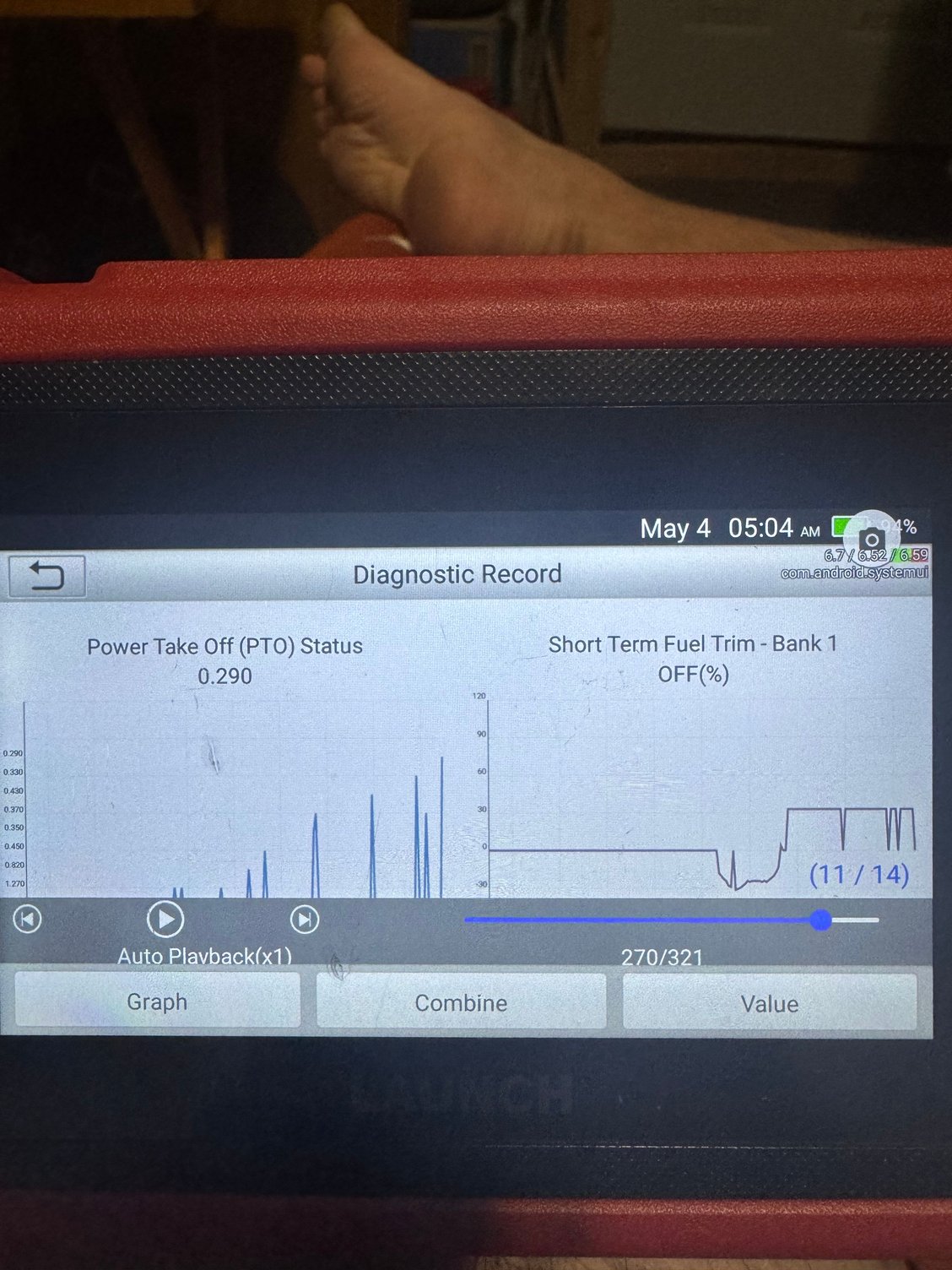

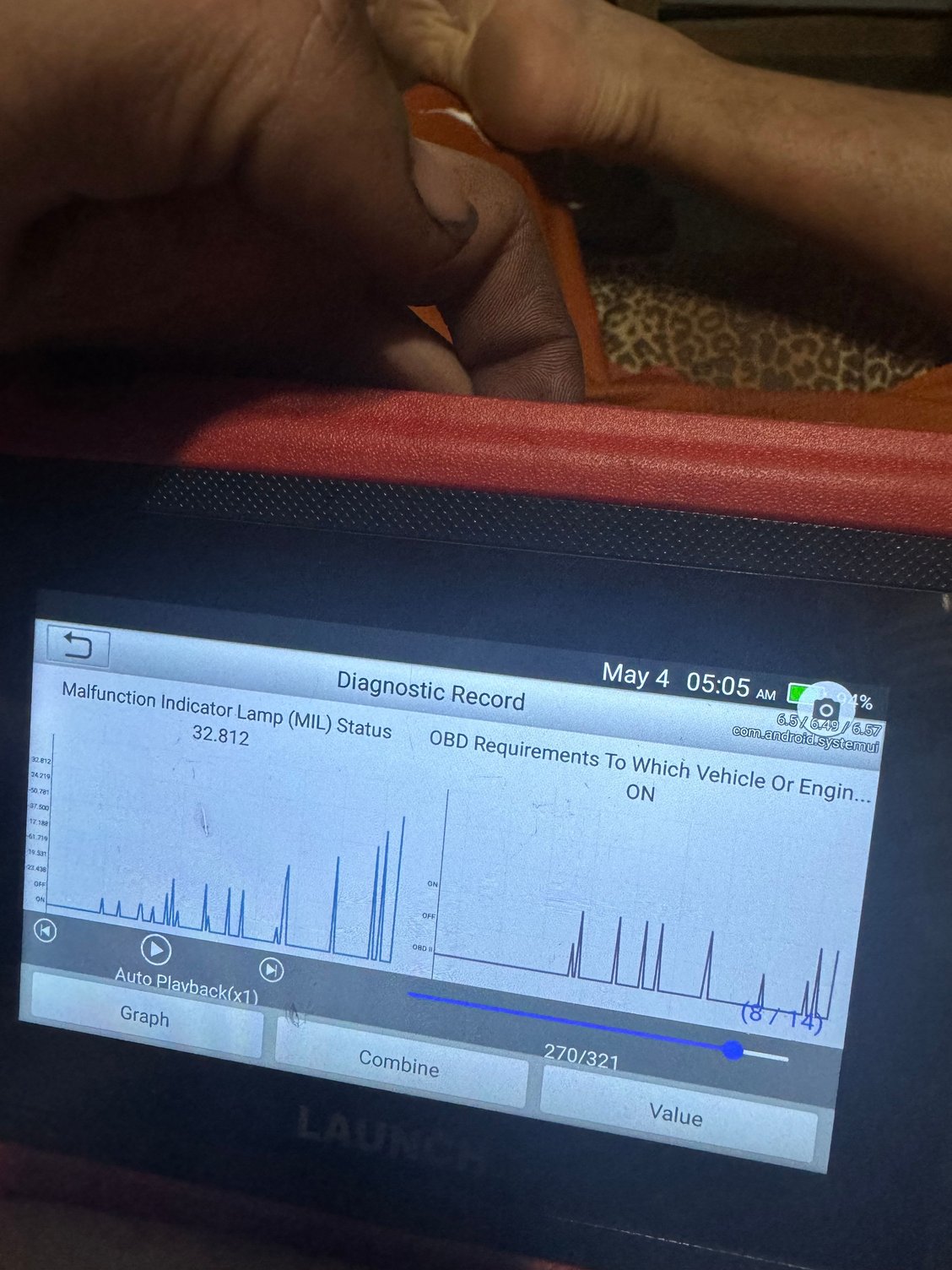

i used a battery and spray can rig and a jewelry cleaner lots of crud came out she fired up ran perfect until i gunned it then all sensors i ges went crazy about 1 min into drive it appears i have a huge electrical problem im guessing iat sensor reading -40, o2 sensors max volt, map goes crazy, all at once and the same times by what im seeing here are some pictures as it wont let me post the recording it all seems to start when fuel loop opens so where should i look or is it a computer fried iv fixed some wiring issues and bank 2 seemed to drop a bit but im not good with electrical at all to time consuming
