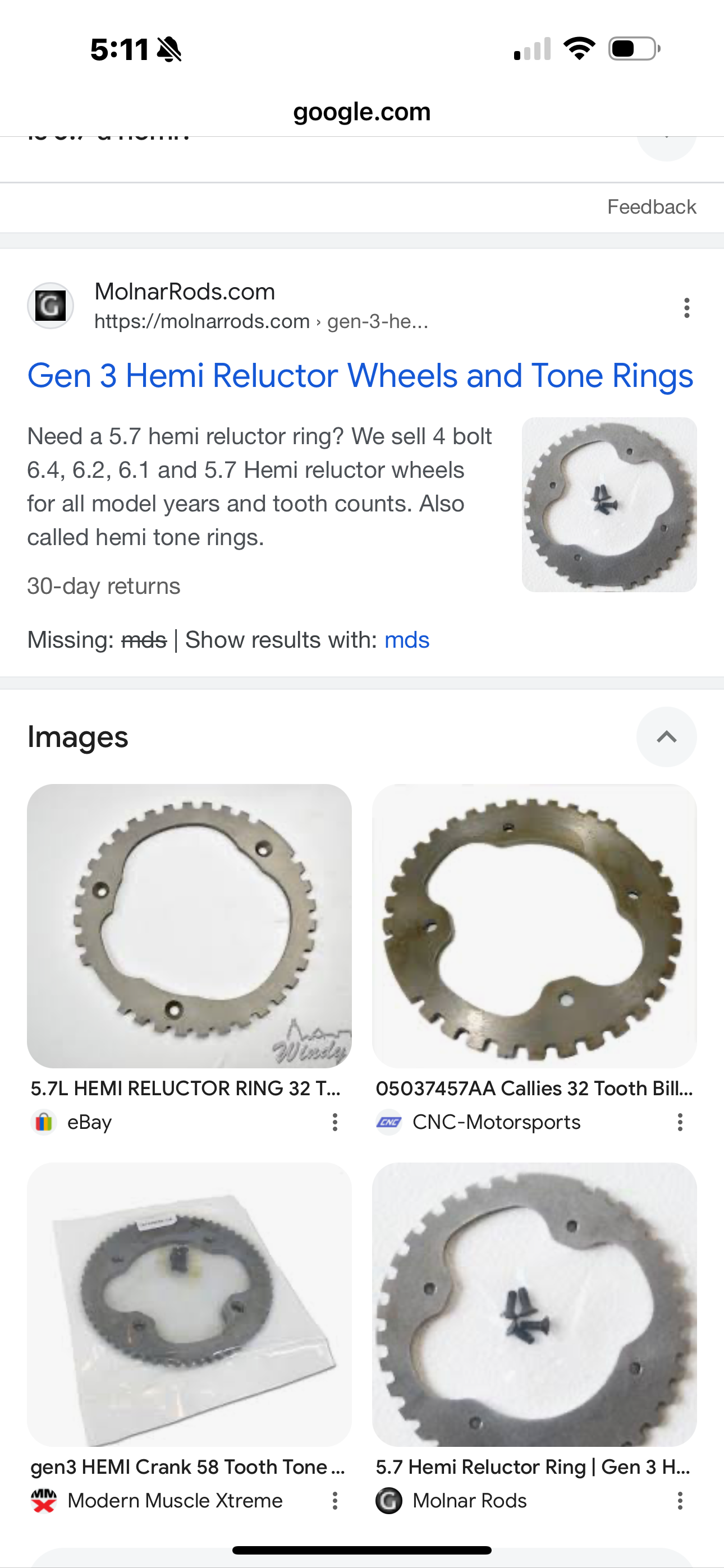

Thanks for responding, HeyYou! So I read that the cam sensor can also be a related cause if I already replaced the crankshaft sensor. In addition, other issues were listed as you stated. When I look up the reluctor ring or tone ring, I’m only getting information for diesel engines and mine is not diesel, it’s gas. All the YouTube videos I watched on it involved diesel as well. They are saying on those, you have to move the transmission to even get to it. I’m a girl and I know a good bit to get me by but I’ve never messed with a reluctor ring. So I’m trying to research it and I’m struggling with it because I can’t find anything on it related to a gas engine. I plan on changing the cam sensor and clearing the PCM and see if that works out but I’m basically running a process of elimination at the moment.

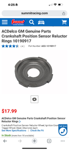

Even when I check auto parts stores online, I’m struggling to find a reluctor ring for this truck and I’ve tried different names (tone wheel, tone ring, timing ring etc…) It’s been frustrating trying to research this one part. Any advise? Or images even might be helpful if able. I would love for this to be a simple enough fix at home but worried that it’s not, I’m assuming this is why you said you hope it’s not the reluctor ring lol. I also hope it’s not the PCM because of how pricey they are. The only thing I was able to find related to my vehicle is when I checked with summit racing (image attached), does this look right? Thanks for your help!
Edited to add I just stumbled onto these (second image) and am thinking this is more of what I need vs the one shown at summit racing. I’ll have to look & double check everything later this evening when able.

Assuming a 5.7, it is bolted to one of the crankshaft flyweights INSIDE the oil pan. I can't really tell if is can be replaced, without pulling the crank out of the engine... Have a look here for what I am talkin' about. It's the toothed while toward the back of the crank. Hopefully, that is NOT your problem.

Thanks! Yes, I actually edited my other response to say I believe I finally found the right one, not the summit one. I truly hope it isn’t the problem either! That will be a nightmare.
