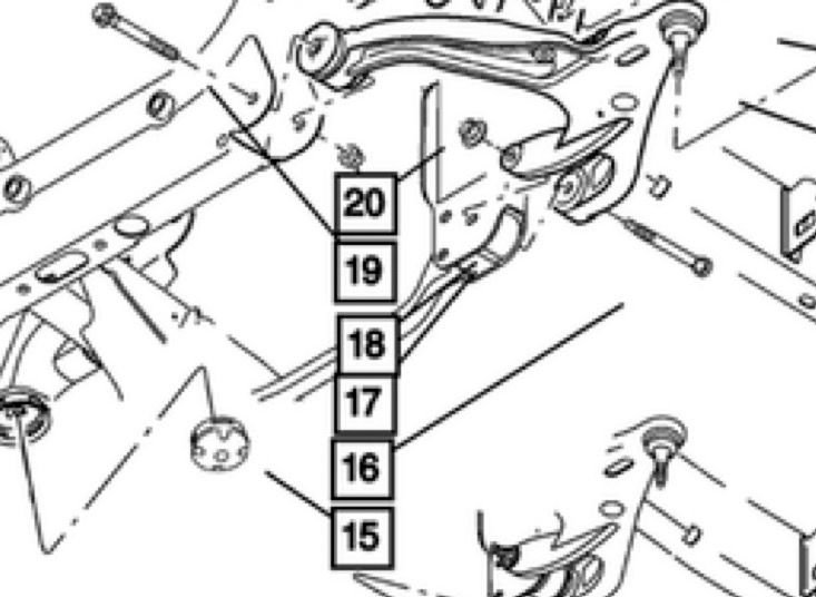

Just purchased my first ram and was in the process of rebuilding the front end and found the LCA bushings to be shot. I’m having a hard time finding the rearward bushing all the part stores I’ve gone to cant locate the rearward bushings does anyone on here have a part number I can go off of?
2005 ram 1500 4x4 5.7 with torsion bars.

. Looked into just replacing the arms but it they only come with the forward bushing the rearward bushing is what I need and I’m having a hard time locating it but think I found the part number 52110063aa looks to be replaced by a moog k200316

Isn't this the rear bushing? From Detroit axle. Drivers side lower.
Reply 0
Jun 5, 2024 | 09:37 AM
Quote: Isn't this the rear bushing? From Detroit axle. Drivers side lower.
that’s the front bushing the rear ward bushing is pressed Into some type of front frame cross member subframe not entirely sure the correct name for it
The bushing resides in #18
Reply 0
Jun 5, 2024 | 09:46 AM
Ok. RockAuto has the Moog part number you posted. Only 2 remaining.
