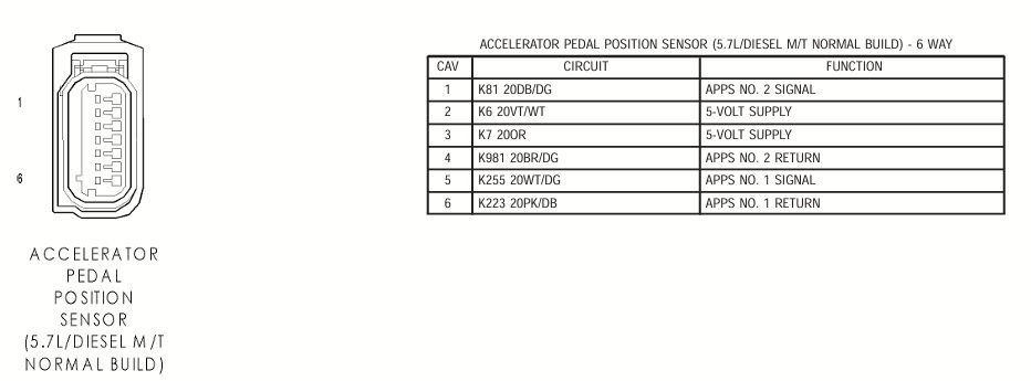

Originally Posted by Prismatic
Make sure you still have your 5v reference circuits, use your multimeter set to 12v dc, don't use a test light. Check pins 2 and 3 to ground. If no power, check pins 2 and 3 for continuity to ground.
Granted, I don't know if those are supplied power KOEO, but I would assume so.
Pins 2 and 3 have 5 volts as they should. They do not test for continuity but pins 4 and 6 test good for continuity to ground. I don't know how to read the picture you sent because no legend but ill look it up if I can.
