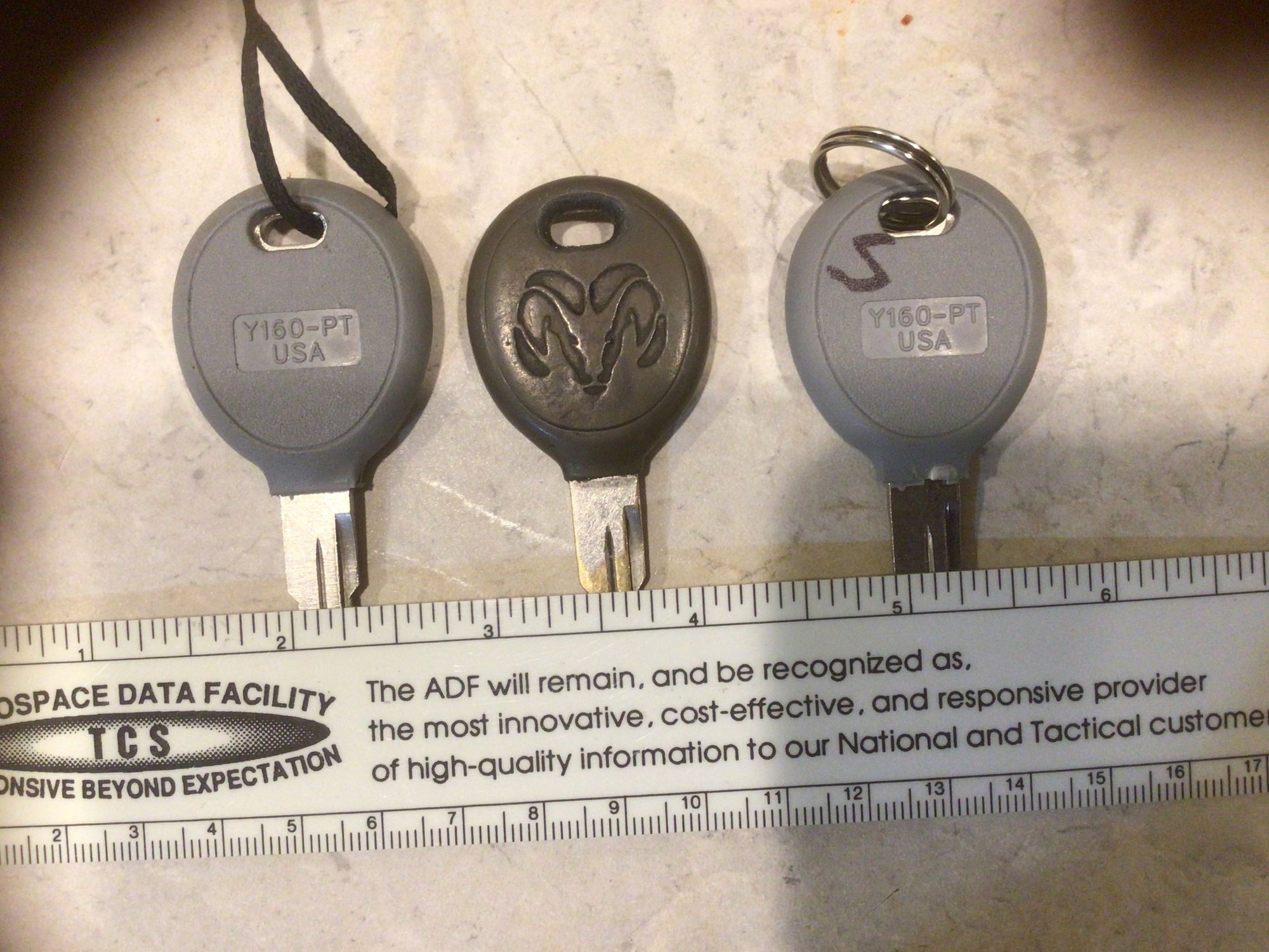

Originally Posted by Alex Medeiros
What color are the keys you're trying to program?
Here is a picture of the three keys that work.

I see two different color keys there.... I don't think that's EVER gonna work....
I’m not understanding. All three of these keys do work.
I thought the key head color only meant if it had a transponder chip or not. Since all three of these keys work, All of them have transponders in them, To prove that I must need a transponder, I got a Y159 metal key blank, copied the key cuts into it, and tried to start my truck. It started for 2 seconds, then died. I then held the transponder key next to the ignition switch, and while using the metal copied key, and it started and ran.
I truly thought the two different color key head in my picture was just the vendors choice of what color they wanted to use, since all of them work.
Just to get me on the same page, what am I missing?
Given what you tried there, that worked..... I have not a clue..... Sorry man.
