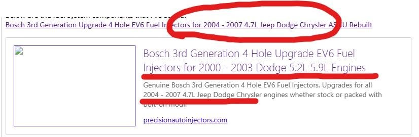

One of these things.. does not look like the other..
Think I've run it down team. I got sent the wrong injectors. The ones I received are orange for the 4.7, the ones on the picture when I ordered them are the black ones from the 5.9. I didn't pay any attention to the color when I got them in. I'll be making a phone call in the morning..
Was running through the setup with a race engine builder I met through a friend who also builds race engines but my friend only works with carbs.
We talked through how the fuel mix must be off and with no exhaust the o2 sensor can't tell the pcm how to mix and is probably flooding.
Then we thought we should also reach out to the guy who built the tune and check to see what PSI he built the tune for because the racers like a lot more poundage than I need and this bothered them.
So I start pulling the parts list and putting it in an email. When I pasted the link I noticed the color of the injector was different.
Went and pulled my injector, got the parts number, looked it up. Checked the order and read the link and details.. sure enough.
I expect this resolves most of the issue.. I'll tow it over and get the exhaust set up while I wait for them to make the injector mess up right.
