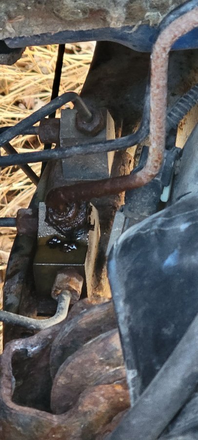

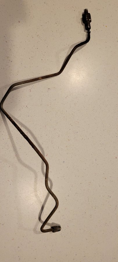

This is entire line:
this is end at block. Broken
and now if I remove broken line from fitting that goes into block.
I believe that the male end of fitting is metric maybe 10 1 but I do not know the female side of same fitting that accepts the line which is probably metric as well.
I am not even 100% for sure what the fitting size size is at master cylinder port end of line.
Please help me size so i may repair my truck as all avenues say line is discontinued.

I am able to find the line, but not the correct fittings.
took the fittings in to tractor supply to size. Sizer specifies the smaller male end of adapter plug is m10 1.0 and female side that accepts the line is m12 1.25

While it may sound cheap .... the old fittings work, as long as they are not stripped out or something.
A cheap flaring tool kit from Amazon .... this one is $20 from Amazon.
You can see the fittings just slide on the line .... the flare at the end of the line is what seals .... the fitting is just a nut that pushes the flare tight to seal.
On my 1949 Dodge truck, I just cleaned and painted the 75 year old fittings and only replaced the lines. ... I'm either cheap, or just too lazy to look up replacements.
Same time I did install a modern Toyota Master cylinder that had the metric threads. Amazon carries a wide variety of brake line fittings .... I needed the metric fittings and a adapter to convert them to standard SAE threads. ... Amazon has all that stuff.
I would just get a line slightly longer then what you need, cut one end off and replace the fittings with the ones you have. Then flare the end and install it.
Order new ones from Amazon or some other on line outlet. .... I'm sure RockAuto has them also ... just more difficult for me to navigate their site to find oddball stuff I want.
