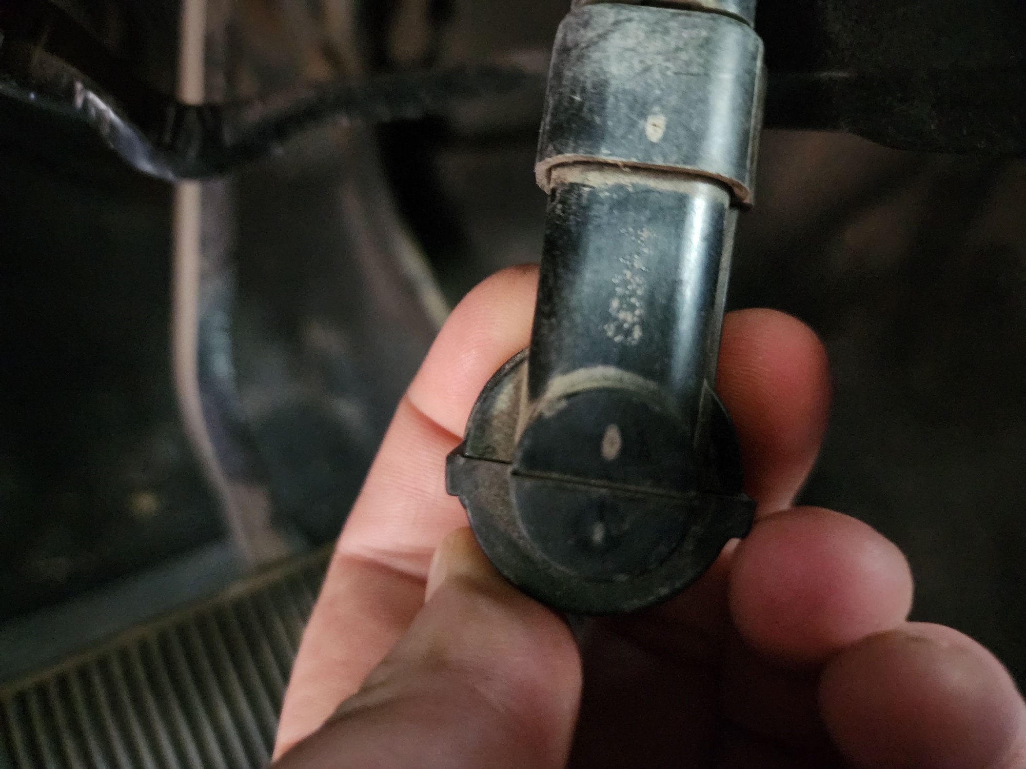

Hey all. I'm a newb to the Forum. Got my 1st Dodge truck (also have 2 Avengers) a few weeks ago. Its a 2004 Ram 1500 5.7L hemi that I bought for $1,000.
Before I get into the issues I'm having trouble with, I found this part dangling from under the dash close to where the gas peddle is, connected to a wiring harness that runs up and feeds through the frame at the e-brake, probably to pcm. No idea what this is or where it goes...
Any info would be appreciated.

An actuator of some sort. Probably for the HVAC system.

That was my first thought, blend door actuator or something. Then I thought, due to its location and the issues I have, maybe it could be some sort of TPS or braking sensor.

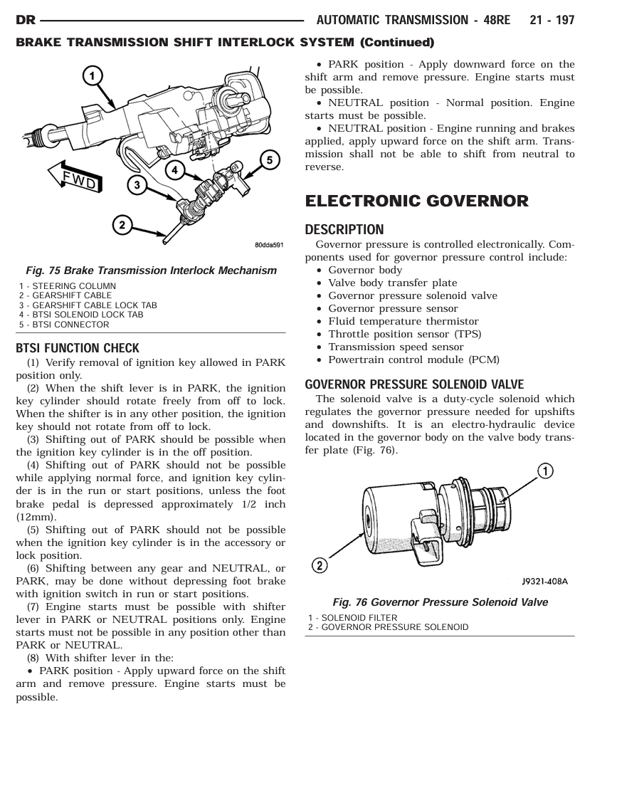

Odd it drives down the road fine. That's your shift interlock solenoid.

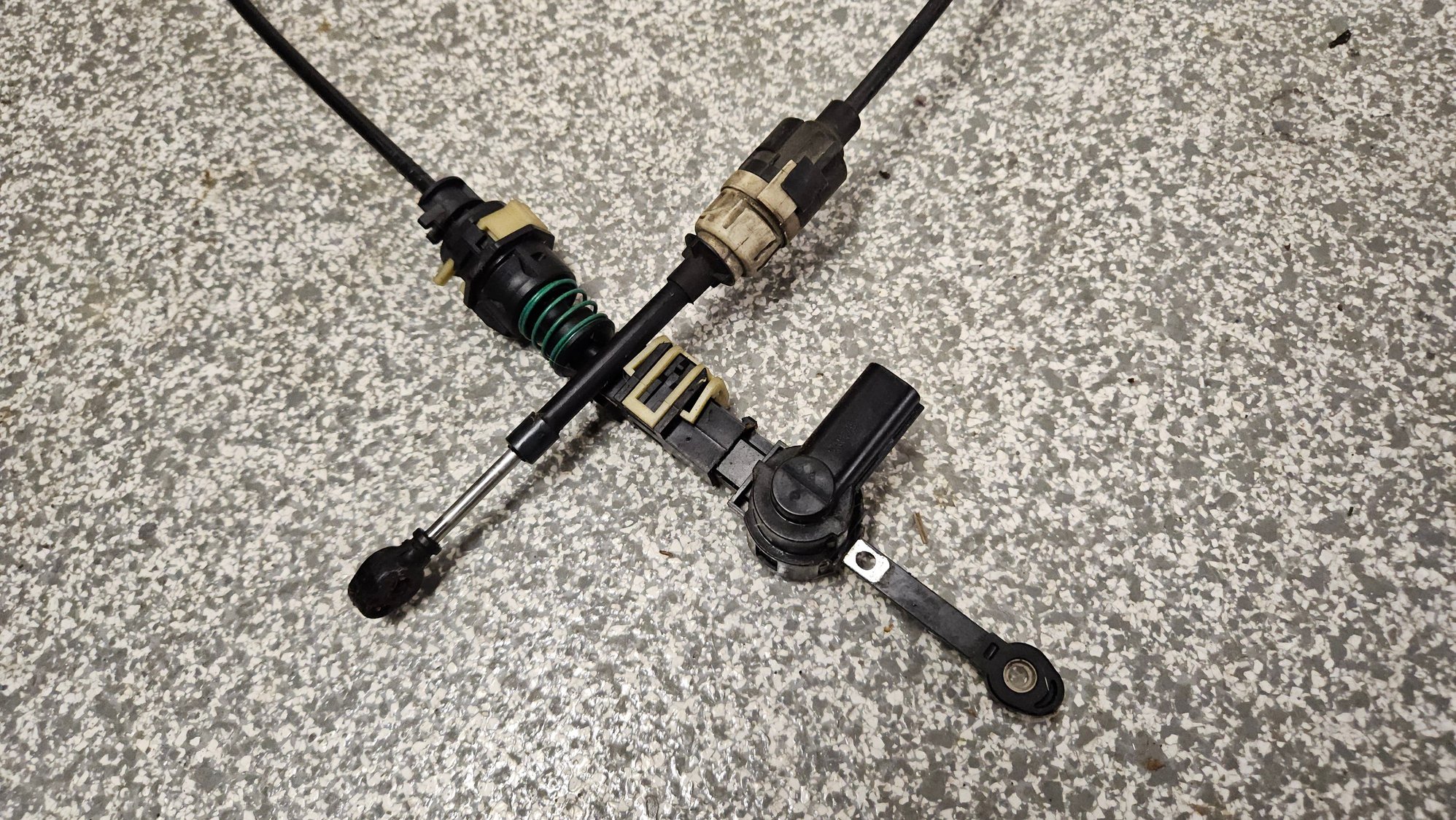

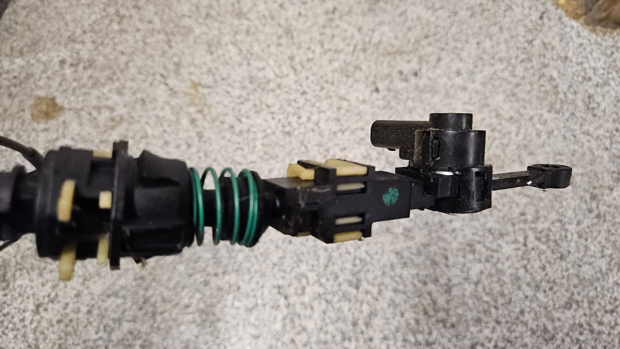

🤯🤯🤯 That looks like the mystery part, but.... how?!?! I haven't had any shifting problems, shifts from park to drive like you'd expect and shifts normally while driving. I haven't tried moving the selector out of park without the key, or into park with ignition on. The only difference is the toothy mechanism, but the pin operates in the same manner. What is the possibility that someone "by-passed" or rigged something rather than replace it? Would this cause any of the symptoms I'm having, or is this just another issue altogether?

Normally you'd have to press the brake to allow it to shift out of park. Try shifting it out of park (engine off) without pressing the brake. No this wouldn't be related to your other issues, what likely happened is someone removed it after having an issue with it.

Well, I don't think it's the shift interlock solenoid. Shift lever wouldn't budge without the brake pedal being depressed. Its gotta be blend door actuator or something.

And that's absolutely your shift interlock solenoid.

If it is my shift lock Solenoid, I can't seem to find where it would plug into.
Normally sits inside the the steering column by the base of the shifter. See that little pin that sticks out of the bottom? That's what retracts to allow you to shift out of park. You hit the brake, brake switch sends a signal to the bus, one place that signal ends up is the interlock to retract that pin. Just in case you have any more doubts about info people who know more than you have given you lol.....look familiar?:
