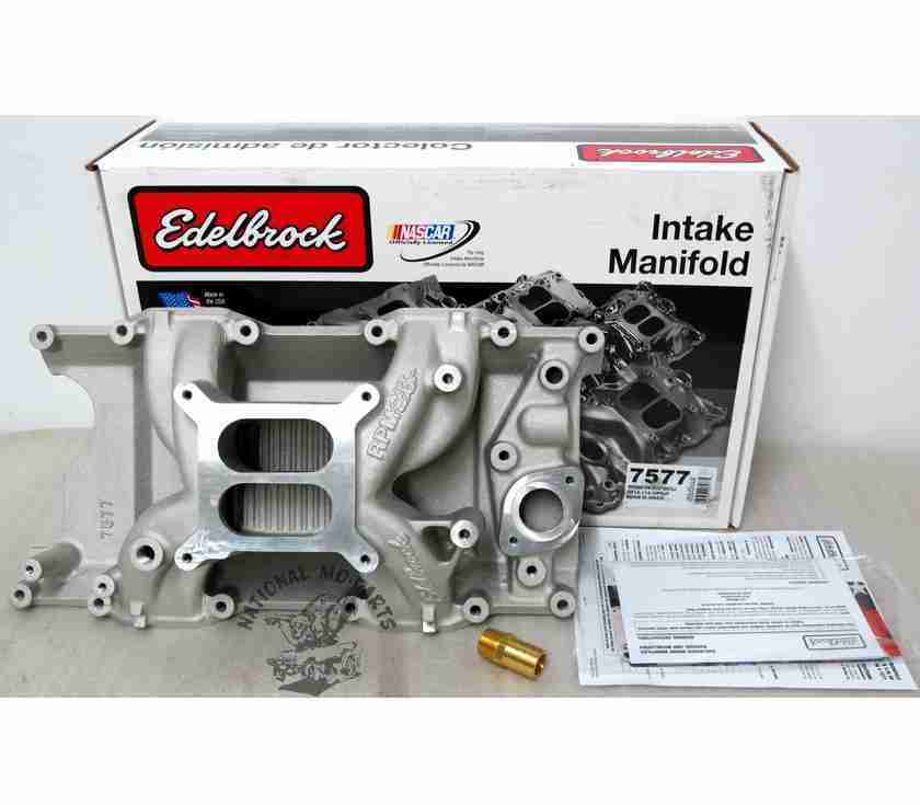

https://ebay.us/m/9r11YB
I’m finding these on eBay. It says it’s for the magnum 360s. It doesn’t have all the extra parts but I could source those somewhere else. I just realized it doesn’t have the ports for the fuel injection either. I just can’t see spending that much on an intake that only gains 20 to 30 hp. It doesn’t seem to be much of a. Selection for this part. I have a modified kegger right now. And I noticed a big difference when I did that.

They are cheap enough, wonder how much it would be have it drilled, and bungs welded in for injectors......

You didn't read the description very well. It only lists compatibility with LA small blocks. That one is not only carb only, but it it doesn't list who actually MADE the manifold (which is important) plus it is drilled for both intake bolt patterns, which I'm not fond of. LA bolt pattern is angled, the magnum pattern is straight up & down.

It looks like a knock off of the Edlebrock.
Have a look in the second gen section i know there are several post about this. This one is for a carb and it's a duel plane not an single plane (open design) like the air gap.
