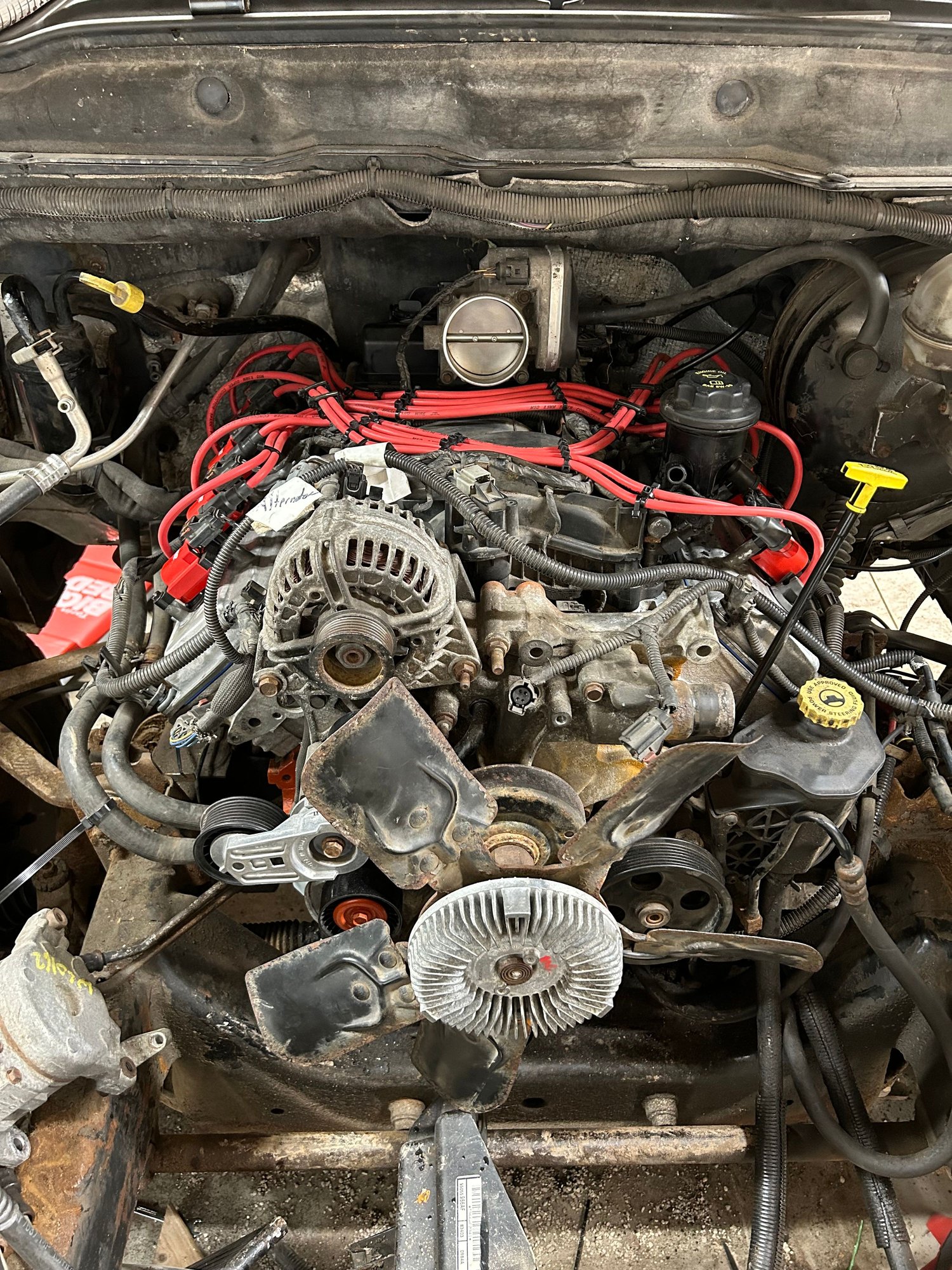

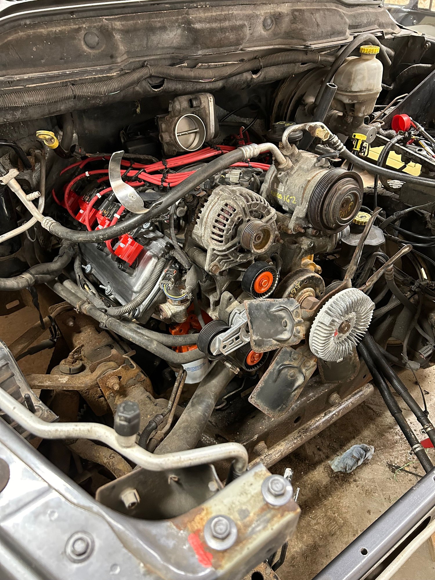

Originally Posted by cloud94725
you have a coil on plug application and that means you dont have plug wires, and the last time i checked the coils cost like $55 and the plugs are a double platnuim plug so they are good for like 100,000 miles but the first 1 or 2 are easy the rest are not real easy but not to hard
that’s false on 03-05 5.7 hemis they have plug wires.
