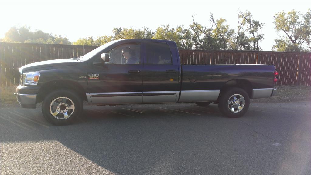

2007 2500 Ram Heavy Duty 2wd Long Bed, 2" Daystar coil overs (KC09100BK) and Daystar 2" lift shocks (KU01004).
Stock tires at the moment, unsure if I really want to go bigger or not.
Attached Thumbnails  Install writeup: 2wd coil spacer leveling kit-2inchlift_zps576b6d7c.jpg
