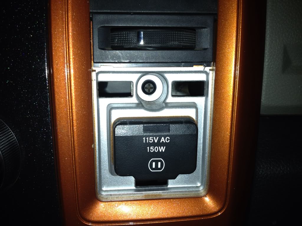

Not really hard. Mostly it all just snaps in.
As for the center stack 3 screws. Two under the rubber mat and one above the inverter.
The door handle buckets: remove cover I'm pointing to and remove screw and pop out.
