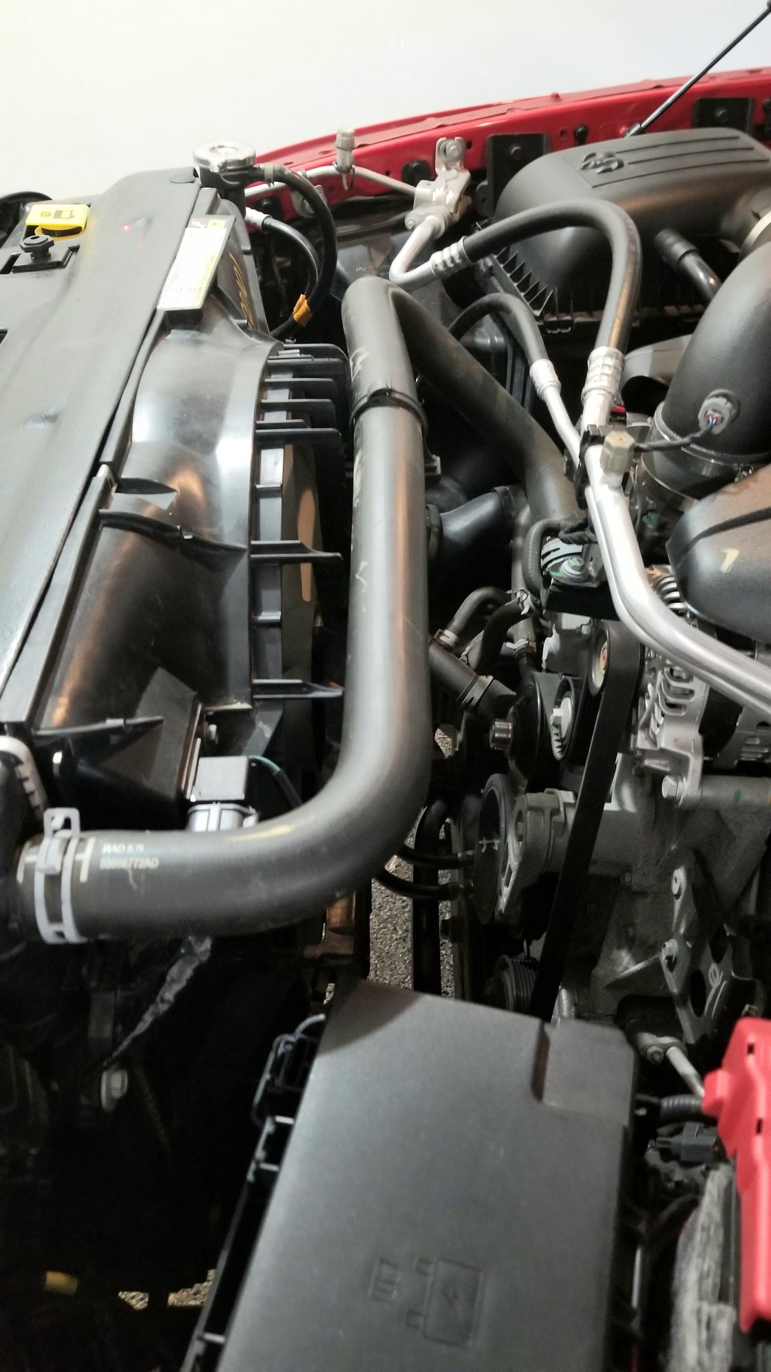

I thought I would bring this thread back to life. Last month I installed an OEM electric fan from a 2012 V-6 Ram on my 2017 5.7 Ram and it was a real easy upgrade. I like the increased MPG and how the quiet engine in now. Plus it looks like the truck came on it from the factory. I have been watching the water temp before and after the fan upgrade and it stays between 197 and 204 so I see no ill effects with it overheating. And the best thing is it was a plug and play upgrade and I did not need a tuner to change any settings. Here is a photo of the small stock fan that I replaced with the larger V-6 fan.
