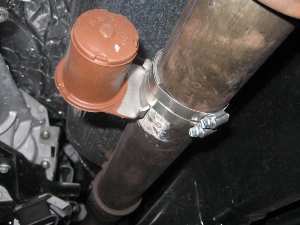

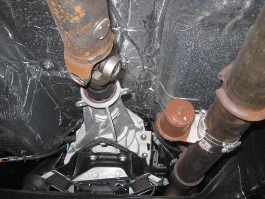

So what are the symptoms everyone is having? I am getting a dull whine at 50-60mph with oscillating vibration in the gas pedal. I put it in tow mode and still have the same problem. The noise is kind of like wom, wom, wom, wom.
Old Sep 29, 2012 | 10:19 PM
  #25
LU229's Avatar
LU229
Joined: Jun 2011
Posts: 1,770
Your Particular Symptoms:
Whine - differential is starting to go away (likely your pinion bearings)
Oscillation vibration in gas pedal - caused by torsional vibrations coming from the engine.
Other 4th gen noise & vibe issues:
These 4th gen trucks also have a noisey torque convertor too (search for Star Case# S1121000005)
(noisey TC is the spline hub and shaft have to much play, cause`s a sound like a bad A/C compressor, cant feel it, but you can hear it)
Anyhow........
Do a search on the 2005 mopar exhaust ballasts, this cures most of the oscillations & vibrations.
You`ll likely need 2 of them, then attach them to the "Y" pipe w/stainless muffler clamps.
You will have to find the "sweet spot" on the "Y" pipe, but it does work very well.
Fixed quite a few gas pedal & steering wheel & seat oscillation vibes with these mopar ballasts.
This is the bulliten number: TSB 11-002-05 (its for an 05 Ram)
I`ve attached a couple pictures i borrowed from another persons truck with the ballasts installed in here... hope this helps you.
PS... these ballasts in the pictures were NOT installed by me, i always use actual stainless steel muffler clamps, NOT hose clamps.
