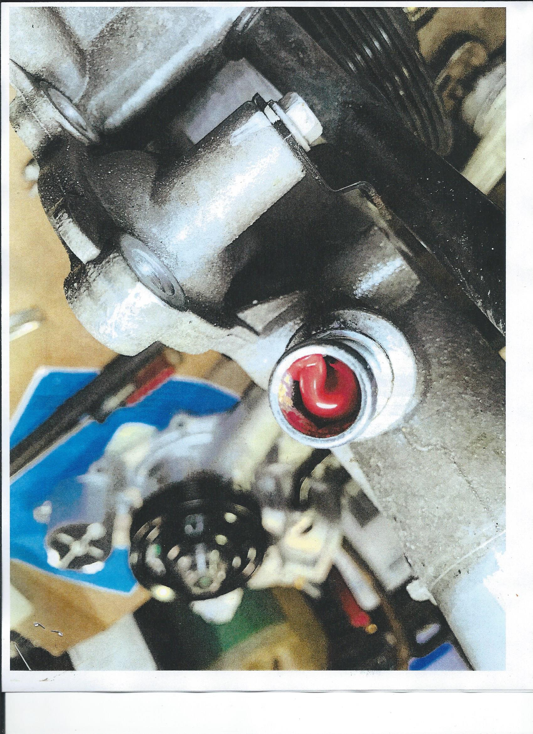

So the service man calls today and says your truck is done and that it was the water pump, there was a obstruction in one of the ports, the mechanic came and got me as soon as he found it, and I know that you didn't think that it could be the pump so I took a picture of it. When I looked at the picture I said you've got to be kidding, someone just squeezed some silicone in there for the pic and he said no that it looks like part of a old gasket. What do you all think?
