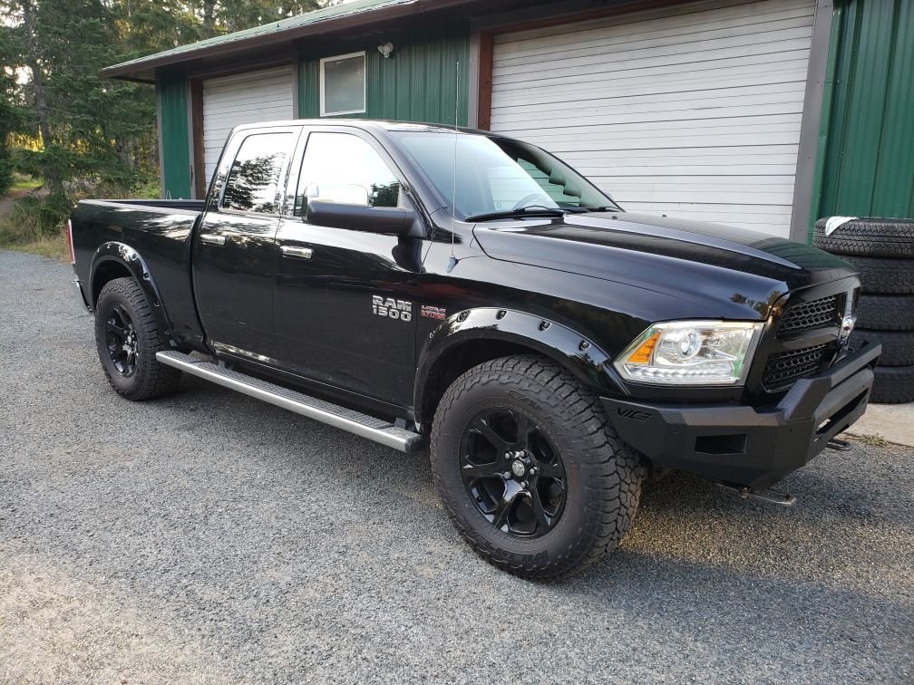

I had the guys at VICE build me one of their cool bumpers in aluminum. It was the first aluminum one they had built. I sprayed it in Raptor bed liner. Still have the lights to install. https://www.vicedesign.ca/bumpers

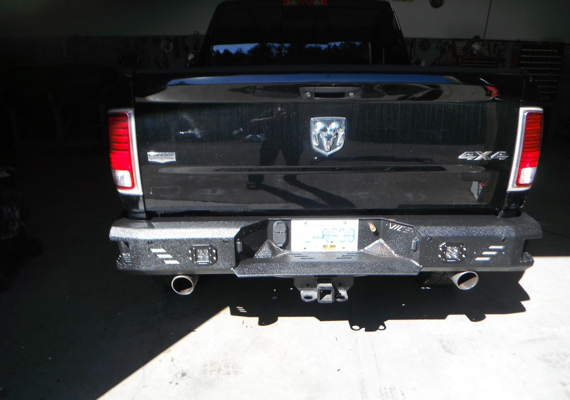

VICE built a nice matching rear bumper and I spent the week prepping and Raptor lining it.
Its a steel one as the added weight over the rear tires is a good thing.
I will be changing to a singe side exit exhaust so I did not get the dual outlet bumper.

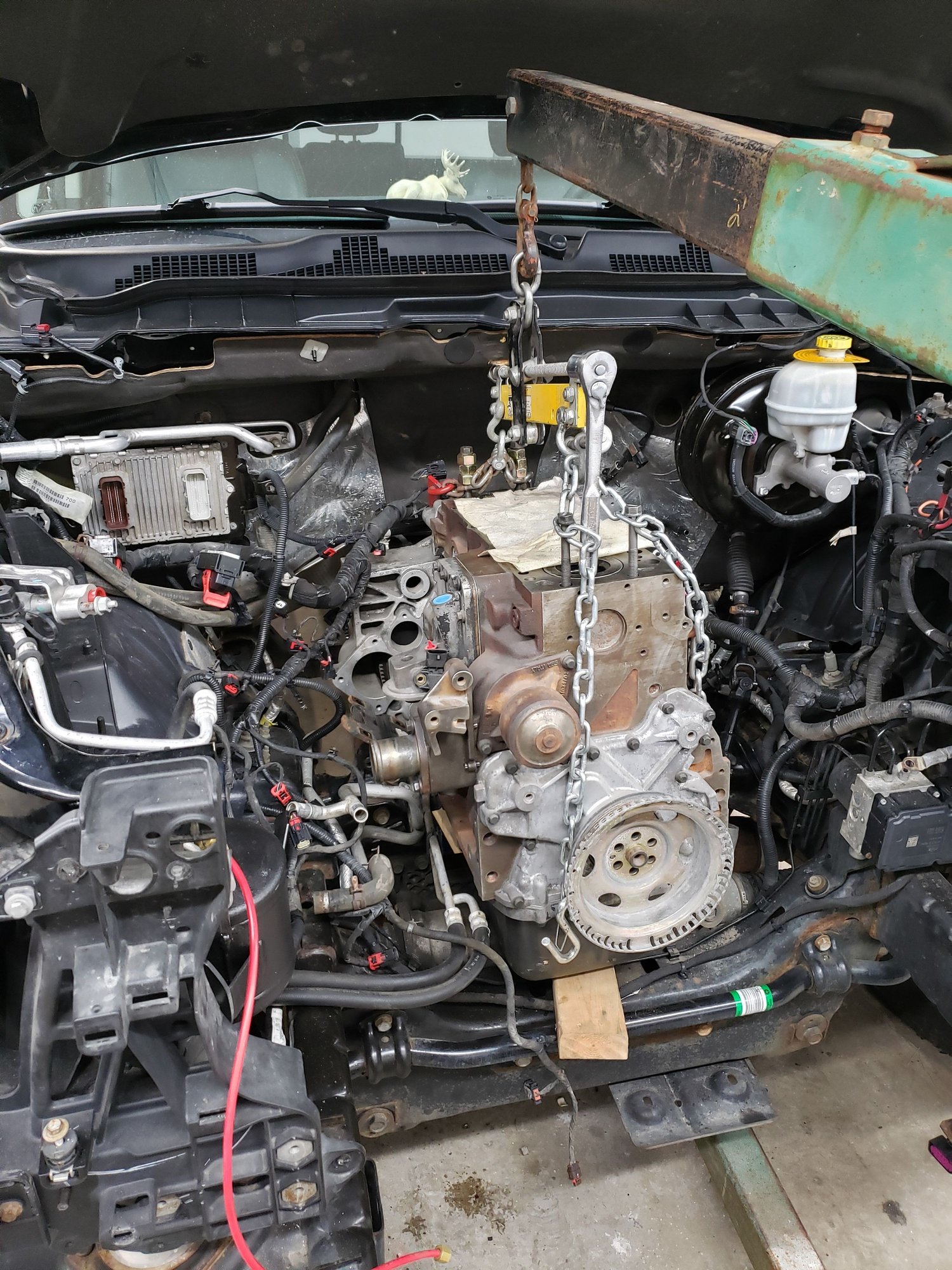

Slowly been removing the Hemi and installing the Cummins. Looks like the Cummins fits pretty good, just waiting on a trans adapter before building engine mounts.

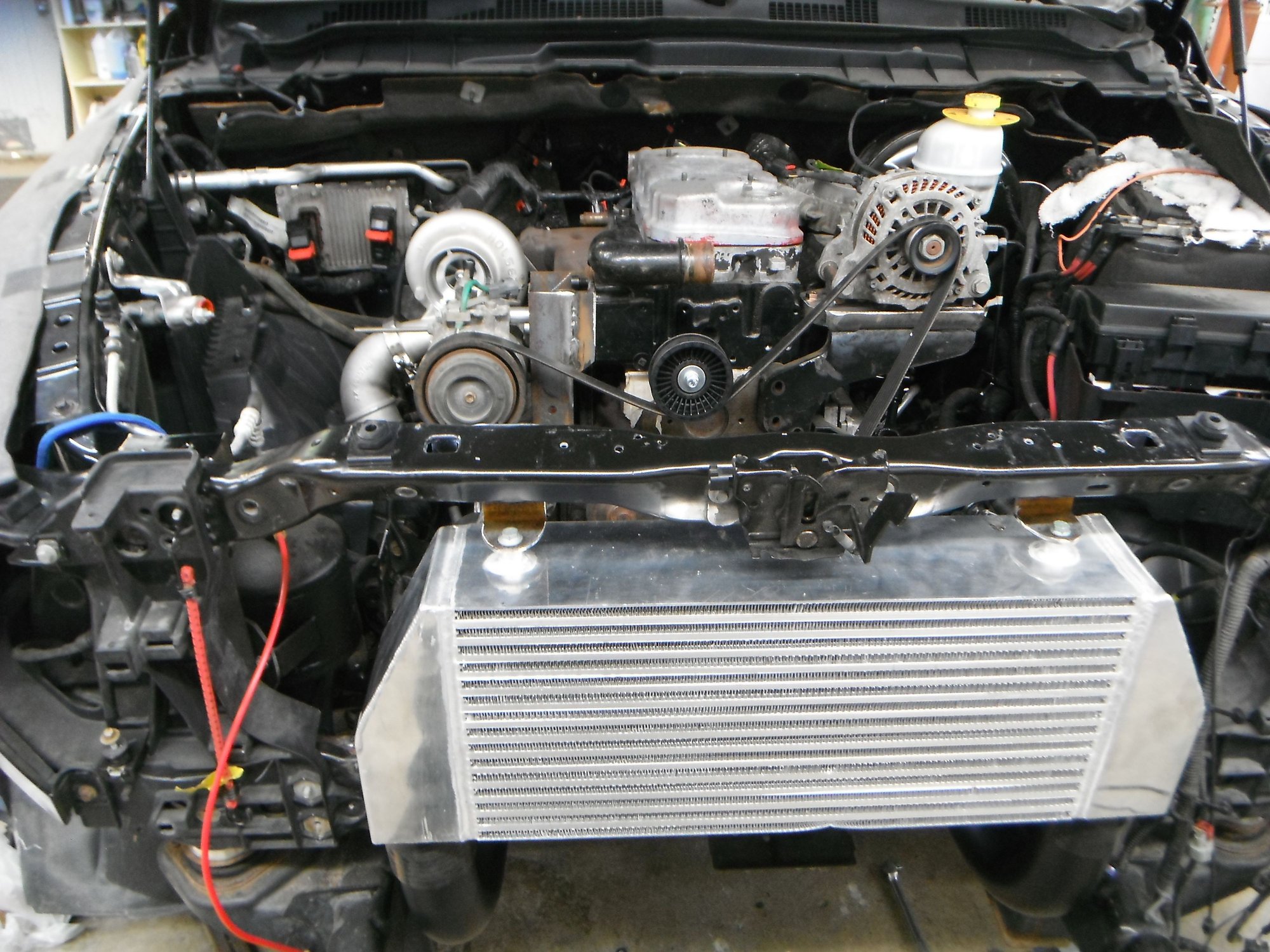

Got lots done on the Ram this weekend. A/C compressor mounted, alternator mounted, intercooler mounted and turbo position figured out.
