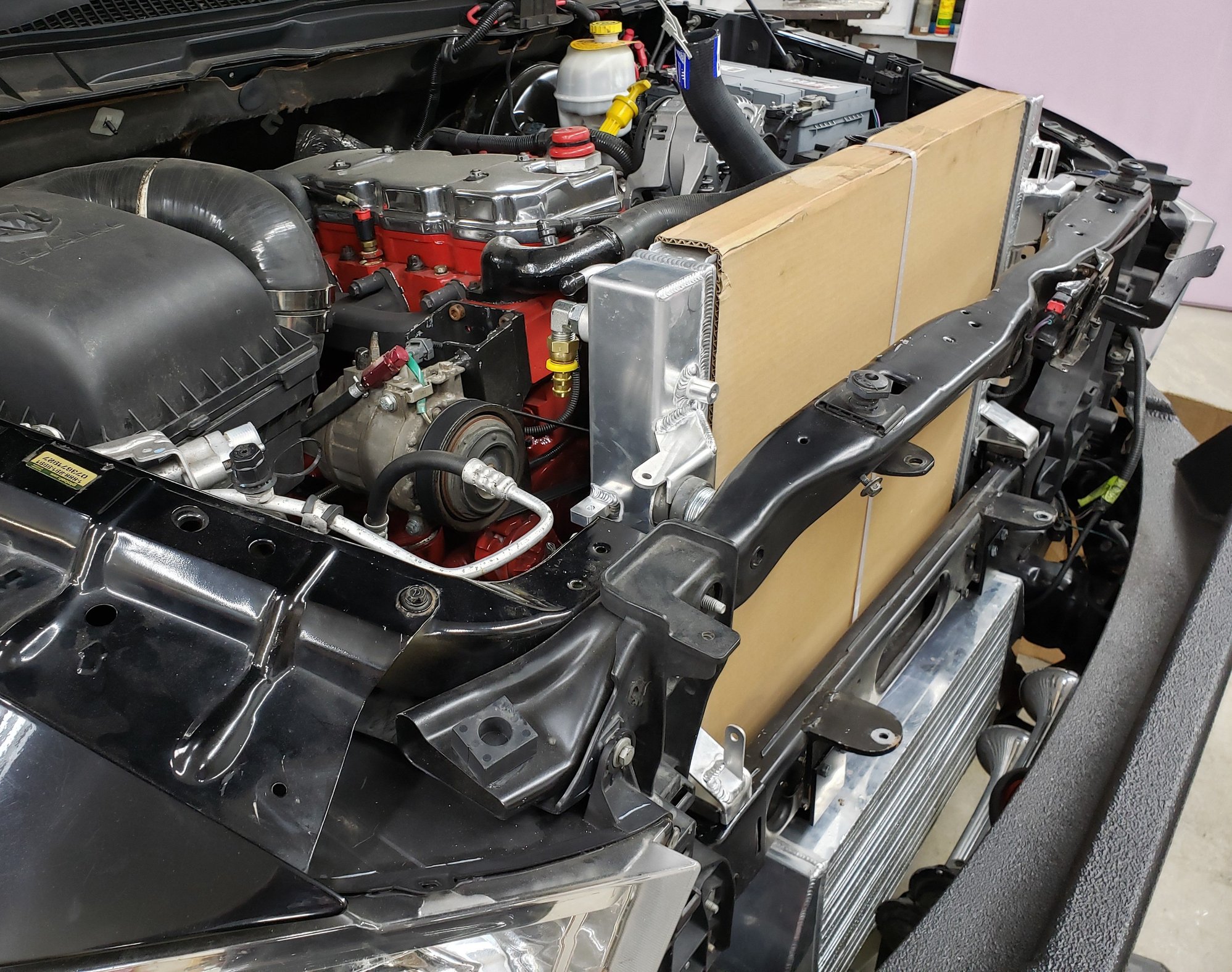

Wow, its been over a year since I last posted.
Lots has happened but the truck has been on the road since last October. LOVE the engine/trans setup. I'm surprised how much power that 4 cylinder Cummins has and paired to the 8 speed and the 3.92 gears it pulls real hard. I swapped out the EPS for an old school power rack from a 2012 truck and mounted a PS pump on the engine. Had some overheating issues with the stock 5.7 rad so I shoehorned in a Mishimoto aluminum one from a RAM 3500 and that solved the overheating. It pulls our little 5th wheel with no problem and looks like its going to get about 16-18 MPG when towing, not great but better than the 5.7.
