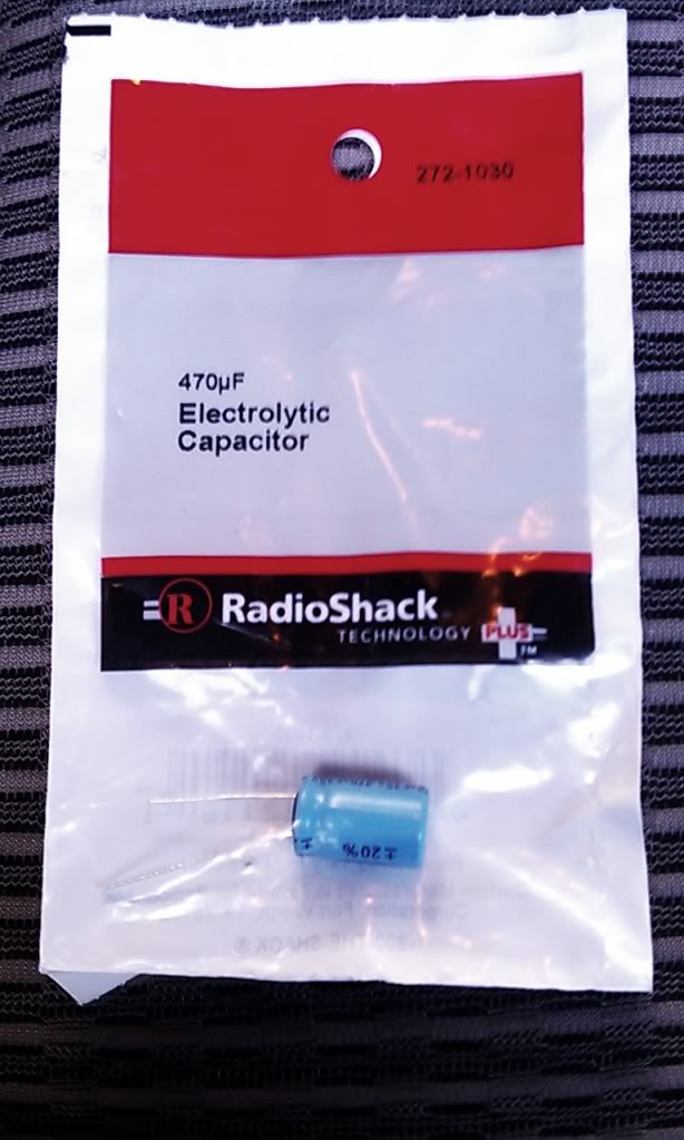

Originally Posted by OneSickHemiRam
All you need is capacitors. One on each side. They'll fool the ECU into seeing the required wattage/resistance and stop the ECU fail safe from trying to shut the system down. I would still recommend using the battery powered relays in conjunction with the capacitors. Which you can get for $1 a piece at radio shack. I still really don't understand why HID sets are being sold without them to anyone with a 09+ RAM.
From my understanding it's not a guarantee that having a 55W set would cure the issue.
Forgive my ignorance, what exactly do I need from Radio Shack? A capacitor or a resistor? What is the specification I need? None of the vendors for HID kits have a clue as to how these lights work in a Ram, LOL. I had purchased cancelers for this reason but obiviously they did not work. The relay I wired works great but I have no headlight delay/illuminated approach feature now. I was thinking of using the headlight TIPM output with a diode to turn on the HID relay for illuminated approach, the diode used as not to backfeed the TIPM when the headlights are actually on.
Thanks for your help.

You nees one of these on each side. You can just insert them in the plug the relay goes to. If I get some time after work I will take a picture of which wires to insert them into. You can't use resistors becuase they will get way to hot tryinf to create what you need.
Old Mar 7, 2011 | 05:03 PM

Thanks so much, I assume they will go acorss in parallel at the plug. I'll let you know how It works.

Originally Posted by RoadRashRon
I got capacitors with my HID's from HIDEXTRA. They sell them for $8 per pair and they plug in between the light and ballast. My lights work perfect.
So basically your saying get a couple capacitors like in the picture above and im styling?
I went to this shop to get mine installed and the guy has been trying to figure out for so long and he told me he needs to wire a relay and what not. But i just think those capacitors would do. Ill see if radio shack has a couple, but i doubt it.
