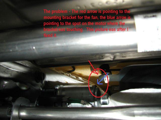

The issue is with the fan for the cooled seat function. If you look at the metal mounting bracket that holds the fan it rubs on the right side (closer to the passenger) seat motor. Unfortunately its a design flaw and there is no way to adjust the fan\bracket further away from the motor, BUT! You can use a zip tie and pull it out of the way. Its a little tight so you may want to get some help from the wife\girlfriend. Hopefully the pictures are ok.

Being your seats are cloth I don't believe they are cooled so this won't apply anyway. If yours are manual seats then it might be covered under the Rapid Response in which case it has to do with a cross brace which needs to be lubed.
The sound mine made was just like an old metal lawn chair with coil springs and it was amazing how you could feel it. I was ready to pull the seat out and start tightening all the bolts in the frame and lubricating the joints.
I'm loving the nice quiet interior now.
