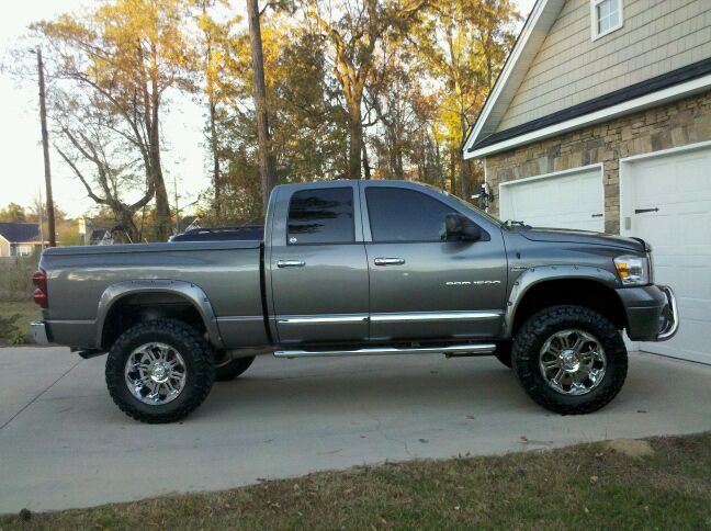

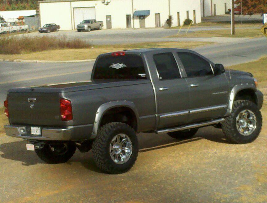

I used to be the same way, until...
Back when I bought this truck new, I wanted a 4WD, but didn't wait to order, and couldn't find a 4WD with this color and options around the area, so I bought a 2WD. I wanted to have a lifted 4WD so bad, but would lose my A$$ attempting to trade, so I said "screw it". I set out to build a truck that no one knew was a 2WD without asking and that was up to my standards. I have seen better examples of a lifted 2WD Dodge Ram 1500 but mine is up there with some of the better ones. You guys who have no use for lifted 2WDs, take a look at this one and tell me if you saw it going down the road, you wouldn't see it and say damn, that looks good. And, if you never saw it again, you would never know it wasn't a 4WD...the following is a description of the truck with accessories...
2007 Dodge Ram 1500 QC Laramie 2WD
5.7L HEMI
Automatic Transmission
Extras:
6" FabTech Suspension Lift
3" Performance Accessories Body Lift
Bilstein 5100 Series Shocks
20"x10" Gear Alloy Wheels
37"x12.5"/20" Nitto Trail Grappler M/Ts
Bushwacker Pocket Flares (painted to match)
Fiberglass Tonneau Cover (painted to match)
Westin Bull Bar
Dodge Stainless Step Bars
AIRAID Intake
HyperTech Programmer
MagnaFlow Exhaust (Headers and H-Pipe)
Throttle Body Spacer
Kenwood Excelon DVD/CD/MP3 with LCD Monitor
Kenwood 1000Watt Amp
(2) Kenwood Excelon 10" Subs in PROBOX under Seat
