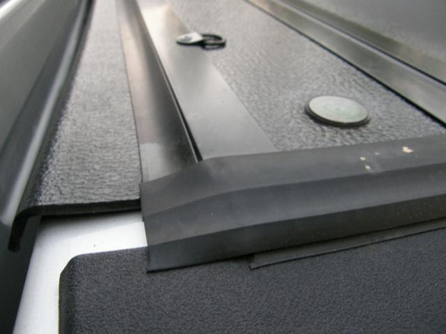

I got the G2. It has rained a bit since I put the cover on and little came in the box, less than I would have thought actually. Is it possible oldjeep for you to take a pic of the front seals? I will try to post a pic of the area.

Posts: 88
This spot...
Attached Thumbnails Bakflip G2 Installation on 09 Crew Cab with Drop In-p9230602.jpg

Posts: 3,497
From: MN
I can take one sometime tommorrow. Your problem there seems to be that you have a plastic bedliner that hangs over the front rail and doesn't go all the way to the side caps. Might need to stick some weatherstrip in the gap on each side.

Posts: 88
Maybe I can just cut the bedliner where it contacts the tonneau rails, then it can go all the forward.
