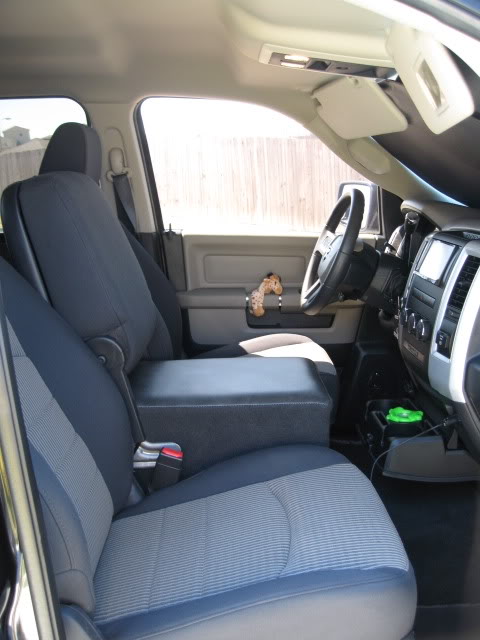

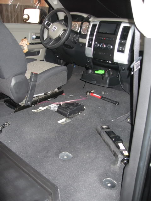

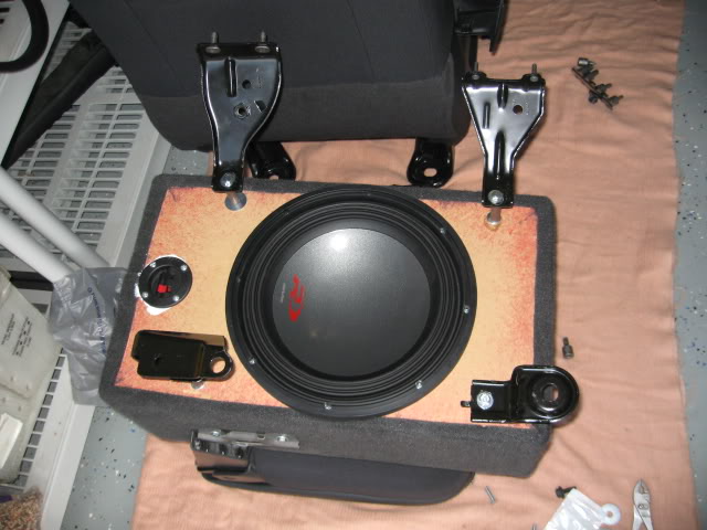

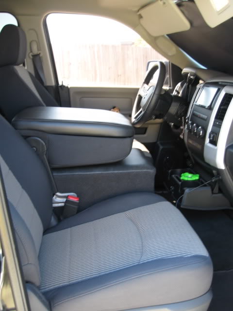

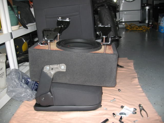

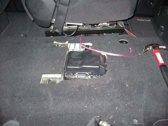

Did the center console replacement with a 12" sub. The specs are for the 3gen but it fits exactly. The only issue was the black box on the floor board, i had to cut and make 2" spacers/stems to lift it off the floor to clear the black box, a 1" space might have worked, but i didn't want to take it all apart again to find out if it didn't work... Sounds great! I've tried the custom box for the back seat with P3 shallow mount subs, sounded like crap, did the 12" solo box just sitting in the back seat, sounded ok but not great, this setup sounds perfect to me, i highly recommend.
