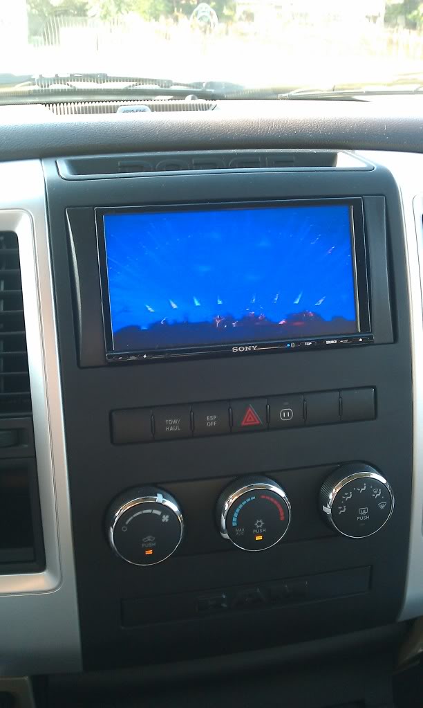

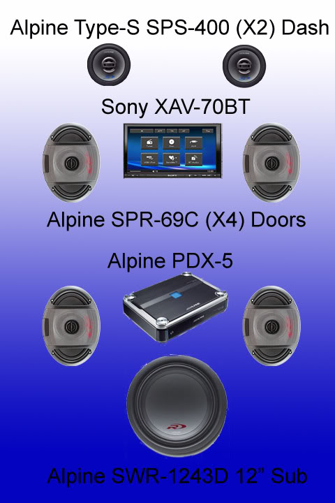

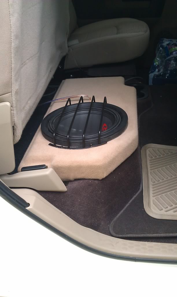

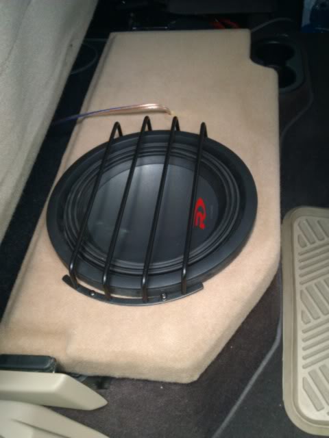

Alright, got my fiberglass box today. It made a big difference. My stereo is done, now just back up camera.
This post thread was/is awesome, saw good systems and great initial run through of stereo install.
Thanks, and here are pics:
