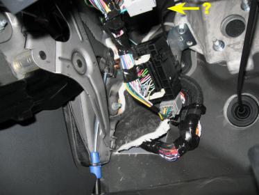

Nice picture of the ITBC, but we already know what it looks like and have determined most dealers don't carry it yet as a part, nor do they have a part number for the pig tails. Heres the pic from under my dash, and I'm thinking the gray plug will be the connector. Now, still have to find the pig tail which is still impossible. Unable to get an answer from Curt yet.

I have the gray plug also (2010) actually 2 gray plugs in the same area, but no luck finding the pig-tail---this is getting to be crazy, maybe a old plug from a later model will plug into the gray one on the 2010's, anybody got onr they can try ????
Has anybody got a 2010 1500 model with the trailer brake hooked up ???

I called 17 dealers, none have a part number for the 2010 for the pigtail. none had a part number for the oem ITBC either. If someone knows, please let us know.

Ordered the Curt harness from autoanything.com. It was $18.95 and shipped free. They said its made for the 2010 specifically, but I will have to cut off the plug that attaches to the controller and use butt connectors which is the way it is for factory harnesses anyways. I'll let you know how smoothly it goes. Its a shame Dodge doesn't have one out yet.
