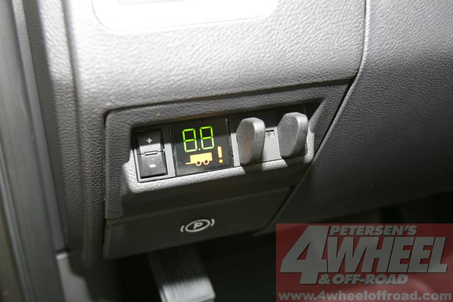

If you have a 2010, you should be able to order the one from the dealer. its under $200 with the bezel to mount to the dash..
Old Dec 20, 2009 | 12:02 PM
iRockCrawler's Avatar
iRockCrawler
Joined: Nov 2009
Posts: 38
Like this
dealer could not find it, anybody have a part number for this ????
Old Dec 20, 2009 | 12:46 PM
topgun's Avatar
topgun
Posts: 703
It is on the Mopar website. It's under Electrical/Modules/Brakes/Item #4. (no pricing or part number) However, you can't just install it as it connects to the trucks computer. So unless they have an upgrade flash, it probably can't be done. Unless the truck has the software already installed??
