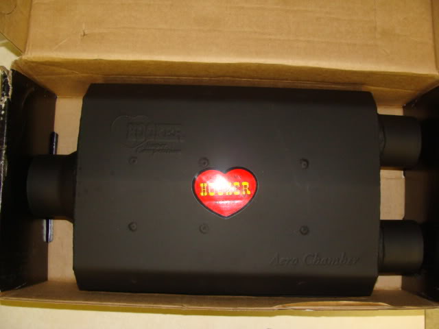

Just posting to see if anyone else has tried using a Hooker Aero chamber muffler......I just got mine in today and I'll hopefully get it all buttoned up Friday. I’ll try to get a sound clip on here I tried searching you tube but all I can find is this.
http://www.youtube.com/watch?v=ScVi1iOyAQY
Here is the muffler I'm putting on.

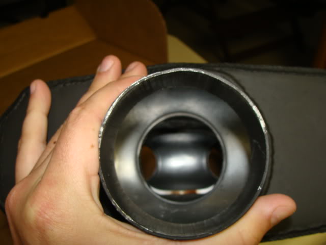

Here is a shot of the inlet

I did. Took a Dakota 4.7 HO QC 4x4, went from 2" to 2.25" after the cats, put in a Flowmaster Y collector, went to 3" there, stuck the Aero Chamber on there, no resonator, surprise, it resonated like hell at 1888 rpm, couldn't even hear yourself think. So I ended up putting the stock resonator back on. Didn't sound bad tho, just resonated without it, a bit louder at cruise without the resonator.

Thanks for the response I'm trying to see if anybody put one on a 4th gen with a 5.7 with resonators and cats.....But I guess I'll find out tomorrow cause I just finished pulling my stock exhaust out so I can bring it to the muffler shop tomorrow to get the pipes bent up.
