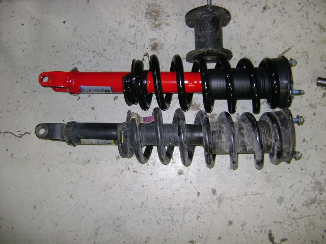

The TRX has different struts. The TRX ones are red and have slightly more preload on the coil. This makes a TRX sit 3/4" higher in the front. You can barely tell in the pictures... but there is a slight difference. The black strut is the one that comes on every other truck.
