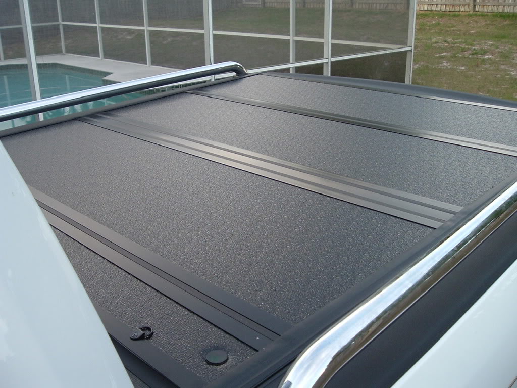

When they shipped the cover they did not include spacers as they supposedly are not needed for the 2010. The leak I had seemed to be from the water overflowing the rails toward the inside of the bed so I called and asked for the spacers. I reinstalled the cover with the spacers in the hopes that they would tilt the rails to the outside more and solve the problem. It did seem to be better after a light rain and now I am waiting for heavy rain to see if it works. I knew going in that the cover would not be waterproof but expected it to perform better than it did. I hope adding the spacers will take care of the problem.
I purchased the cover because I liked the way it is designed to fit and work and the fact that there are no external locks. I don't regret the decision and am 90% happy with it. I hope the spacer fix will take care of the leak and get me to 100%.

Good luck. The install is a snap to do just make sure the rails are as far forward as you can get them. Be carefull with the two front screws, I put a slight dimple in the panel because I over tightened them. I hope they send the spacers with yours.
