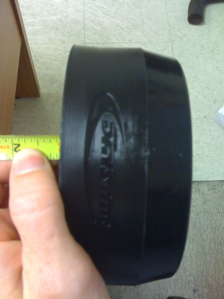

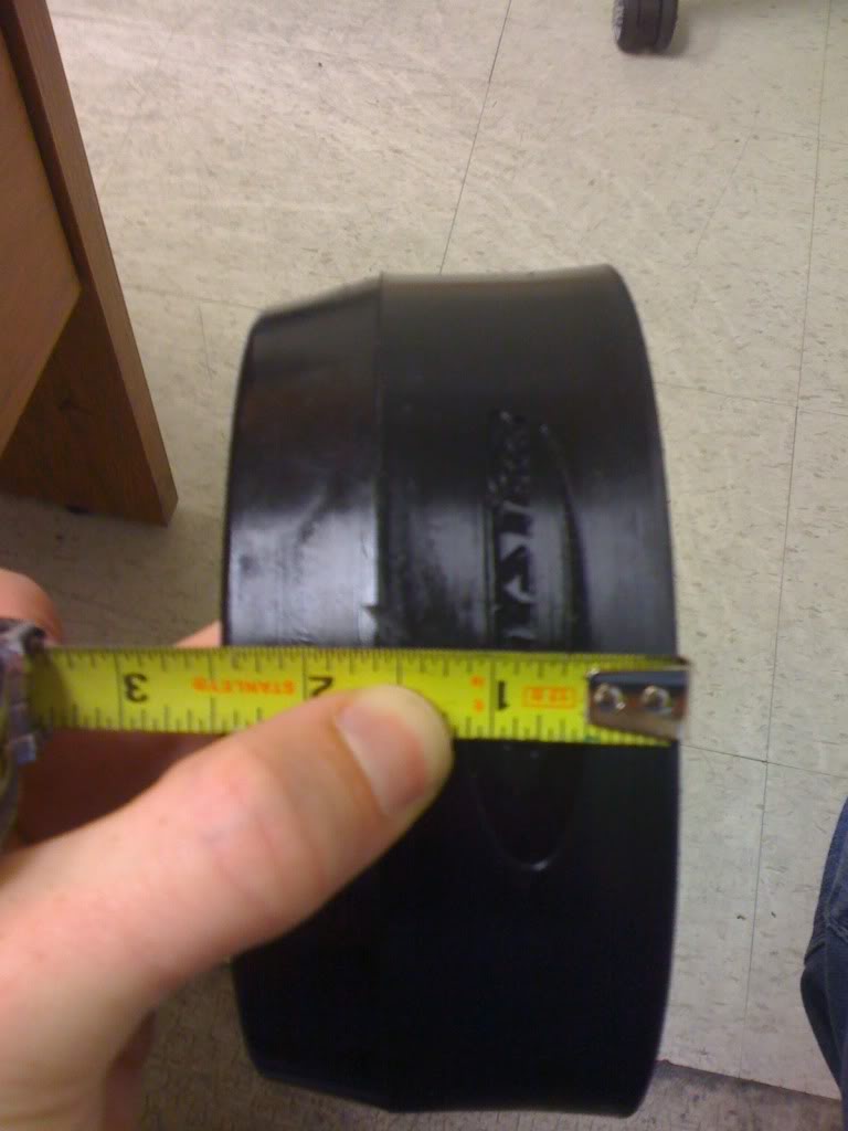

Here are some photos of the new spacers. The overall length is 2.5" and the spring seats 1" into the spacer. Therefore the thickness seat to seat is approx. 1.5".
Does this sound like the spacer you installed. You have me worried now about having them install these, haha.

On another note, I was curious and looked up the part # for the spacer they just sent me. According to their website:
KC09100BK
Comfort Ride
DODGE
RAM 1500 2WD 94-01 2.5" LEVELING KIT
RAM 2500 / 3500 2WD 94-10 2.5" LEVELING KIT, LONGER FRONT SHOCK ABSORBERS REQUIRED (AVAILABLE SEPARATELY)
I'm going to call them back...their site claims that it is only compatible with the 94-01 Dodge Ram 1500.

No mine were even bigger.......those I think will still be too tall.........that is about 3 inches of lift, and unfortunatly, with that much lift the springs will be compressed a lot, giving you a harsh ride, it will lift it...but at a sacrifice, as long as you know that going in ,it is ok, they will fit. 2 inches total is about all i would go with, the 1.5.s i had in there at first, were not really felt at all, these 2 inch now ,i can feel but it is not bad at all, anything bigger YOU WILL FEEL..... A LOT, great pictures also. I will try and find a way to show you my spacers i put in now.

The spacers will fit the older dodges too ,so dont worry,
