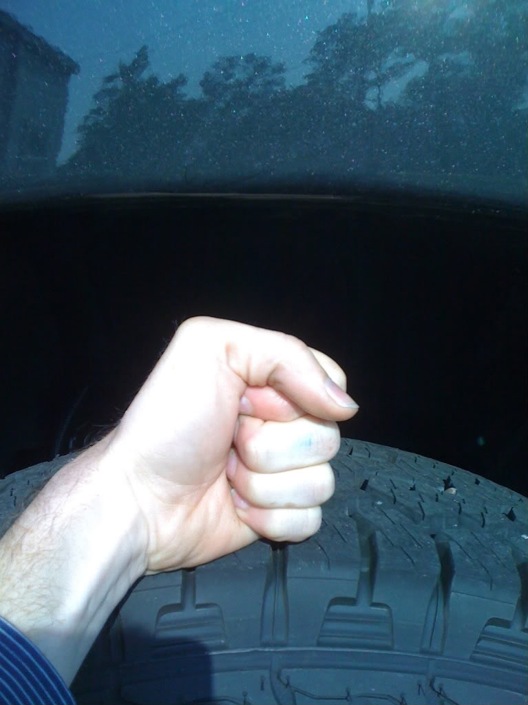

Here are some before and after shots...On the full shot, the before pic is the best angle I had. I also had smaller tires on the before pic. I'm running 285/70-17 now.
Before (full shot):
After (full shot):
Before (close-up with reference)
After (close-up with reference)

that truck is looking good,didi you notice yet ,that depending where it is parked, the springs in front seem soft, it will look off level depending on what it is sitting on, at a store it might look level, thn park at another place it looks un-level, WEIRD, thanks for the pictures , send more after the 2 inchers are in there, measure them BEFORE they go in of course.

Yeah, I've noticed that too. I'll take photos after the 2 inchers...and I'll measure the difference from 1.5" to 2"...unfortunately I won't be able to get a stock/2" comparison since I have the 1.5's in now.
