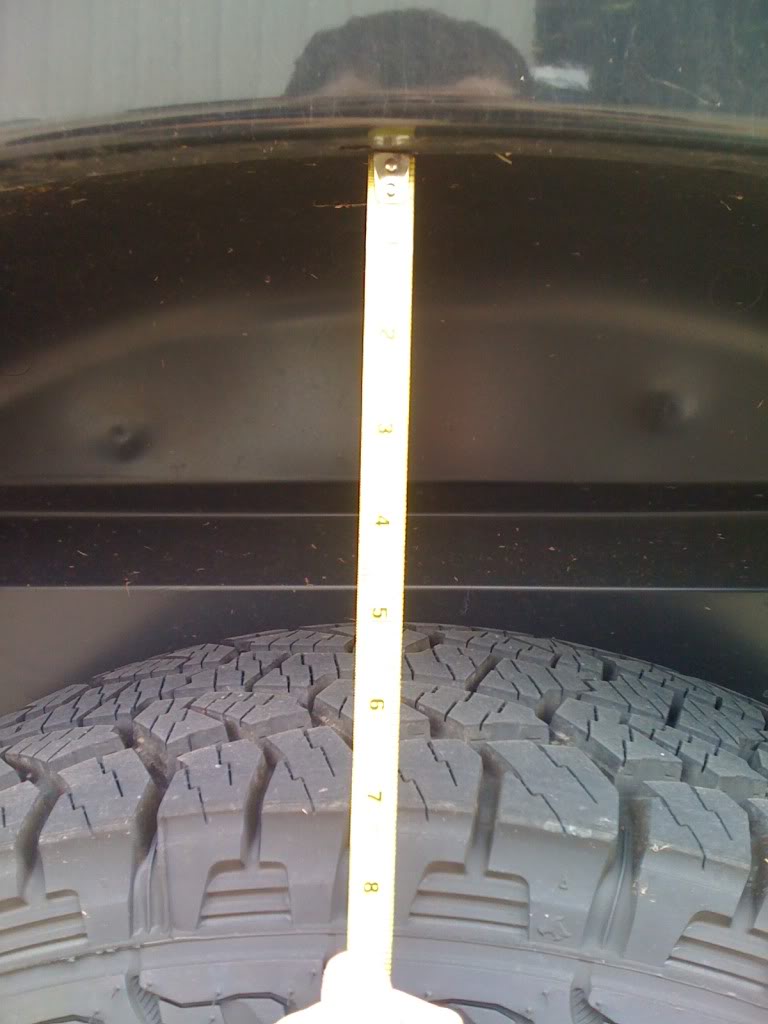

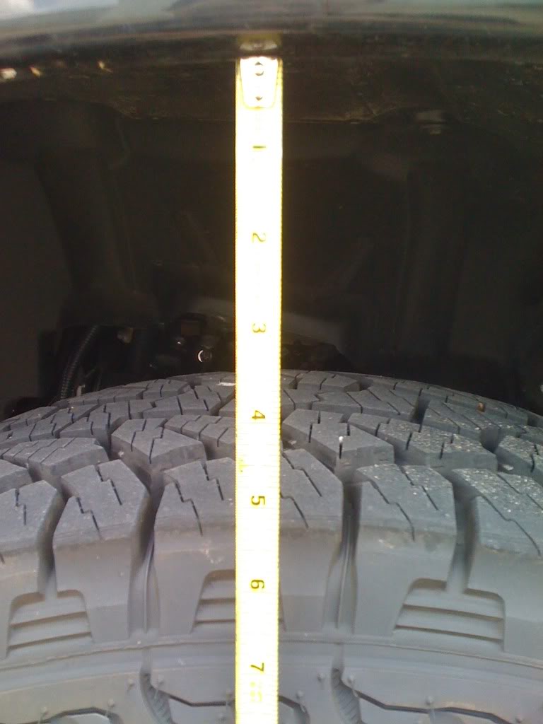

My Daystar 2" Leveling Kit is being installed now. Here are the before shots...keep in mind my truck has the 1.5" spacer installed in these photos. After shots to come later.
FRONT TIRE:
REAR TIRE:
You'll notice there is still about a 2" difference between the front and rear. And this is WITH the 1.5" spacer installed.
