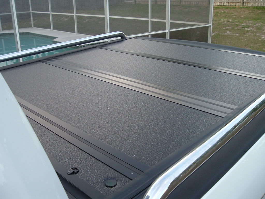

I had a Bakflip G2 that I had some issues with a while back. I was told to e-mail jmaimin here on the forum about the issues. He promptly addressed my concerns and agreed to send me a new cover. He shipped me a new F1 and had someone personally call me to give me the tracking information. He was very professional throughout the entire transaction. The G2 gave me a lot of good use and when I did have an issue with it Bak Industries went out of their way to see that I was taken care of.
Do not hesitate to buy from Bak Industries, jmaimin, or any of their distributors.
Here is a pic of the installed product on my Ram

Definately a great cover. I had leaks at first but repositioned and added spacers. I was told you didn't need spacers on the 2010's but after I put them in there were no more leaks.

Sounds like you have the same leak I had, mine didn't come with the spacers either I had to request them. I felt that without the spacers the rails tilted slightly to the inside of the bed thus allowing the water to overflow the channel. The spacers level the rails more so the inside is not lower than the outside.
Another tip is to try and park uphill so the water can flow out the tailgate. I was told that the drain cups up front can't handle a deluge without overflowing. Since I put the spacers in and park uphill the bed is dry as a bone.
