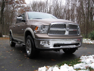

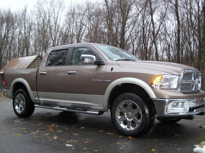

OK ... the ReadyLIft 2" leveling kit was installed today. I was a bit concerned as the shop had not done anything like this, but it went without a hitch. Took about 2 hours (or so) and I was charged $250 + tax for the install and the front end alignment. I told the shop that $250 was going rate and that 2 hours was the time folks had quoted. Go figure. I'm happy.
The truck looks much better in my opinion. Much more aggressive than the snoop dog, nose down look the stocker Laramie had. The ride seems the same to me. I think that there is a bit more lean on cornering, but that is expected. The 'look' over the hood from the cabin is different, too ... more like my F250 of a decade ago. You can't really see over the hood.
Guess now, I'll have to stop at Cabela's and get a gun rack, eh.
I'm hoping that the kit allows me to hook up my Western plow easier ... dismounting as well ... this was the primary purpose of the ReadyLift kit. I just switched the plow over from a F150 and had to drive up on patio pavers to get the plow off and on. Sucks. I hope this makes a difference ... and, of course, it looks much better. The measurement is exactly 2" taller at the fender flare. Kewl.
