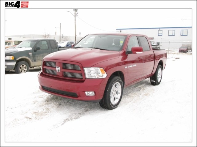

2011 Sport, she does have fogs and I believe the 2011's have quads.
Cherry Red 2011 Sport CC 4x4.

Like you, i`ve owned dakota`s, they were ok for headlight lighting, not great, but better than some vehicles i`ve owned in the past. I guarantee you love the quad lights in that 2011 sport truck you`re buying, over the dakota lights. I have a 2010 sport, if you aim the lights higher, you`ll proabaly like the headlights just fine. Mine were (like all the rams) aimed way to low from the factory. I re-aimed them and way better now, and they are tons better than the dakota trucks i`ve had in the past for lighting. As for HID, do it right or dont do it at all. I`ve had them, took them back out within a weeks time. I didnt care for the fact of loosing all my sideroad lighting ability, thers alotta deer where i live and i dont like the fact that i cant see the sides of the road with HID headlights. I put my OEM headlights back in, and much happier. I also jumped up to 65watt low beams, 100watt hi-beams. Keep in mind if you happen to do this 65/100watt upgrade, you`ll want to spend the extra $25 bucks for the porcelin pigtail connectors when you jump up to 100watt bulbs. If you dont, the 100watt headlight bulbs will melt the connectors in the back of the bulbs where you plug them in because they get really hot. The porcelin connectors wont melt. I didnt have any codes show up either. I think the guyz with the HID`s are complaining of this because the HID flickers issue. Anyhow, good luck with the new sport, i think you`ll like it as long as you got one that was built on wednesday...lol.
PS....silverstar bulbs, dont bother wasting your money, they aren`t worth it, been ther done that, to much money for a bulb that has less light ability and a short life span. Also, if it has "BLUE" tint on the bulbs, stay far away from those as possible, blue tinted bulbs wont shine very far.

I think my fears of poor headlights in my 2011 have now been extinguished! I bumped into an old friend tonight that I haven't seen in years and he is driving a 2011 sport. Long story short after a short drive in his truck I have to say the headlights are leaps and bounds better than my old Dakota. I'm still thinking long and hard about HID's and projectors though.
I was also pleasantly shocked at how smooth these trucks ride. It's been over a year since I test drove one and completely forgot how smooth these bad boys are. The wait is really going to be hard now as I know what I'm missing!!!!
