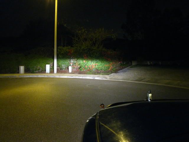

HEADLIGHTS

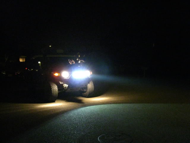

NOW HEADLIGHTS + HIDS

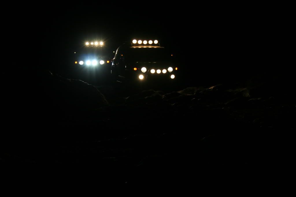

Yea, they are ridiculously bright... try turning them on while on the road, the street signs get so bright from the reflection you won't be able to see anything!
Low beam and IPF 968 using 100W bulbs
Low beam and HID offroad

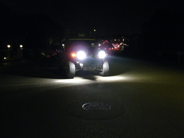

Here's a pic of those HID offroad lights i just installed. They are insane bright no even funny.
