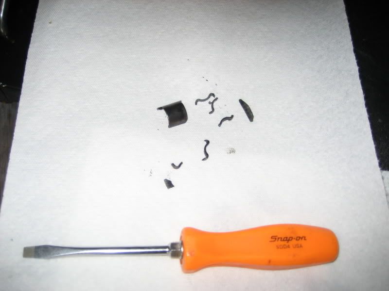

Look at the LSD if you have one and carefully inspect the clips for broken pieces. Dodge swears they have fixed the dreaded "C-Clip" issue that has caused so many rear end failures since the 2nd Gens were introduced in 1994, but they swore that with the introduction of the 3rd Gens and again when they did a slight re-design in '06 and they are still self destructing on people.

Broken "C-Clip" found in diff. this is impending disaster as the pieces will eventually tear up the gears and could cause the entire housing to fail:
