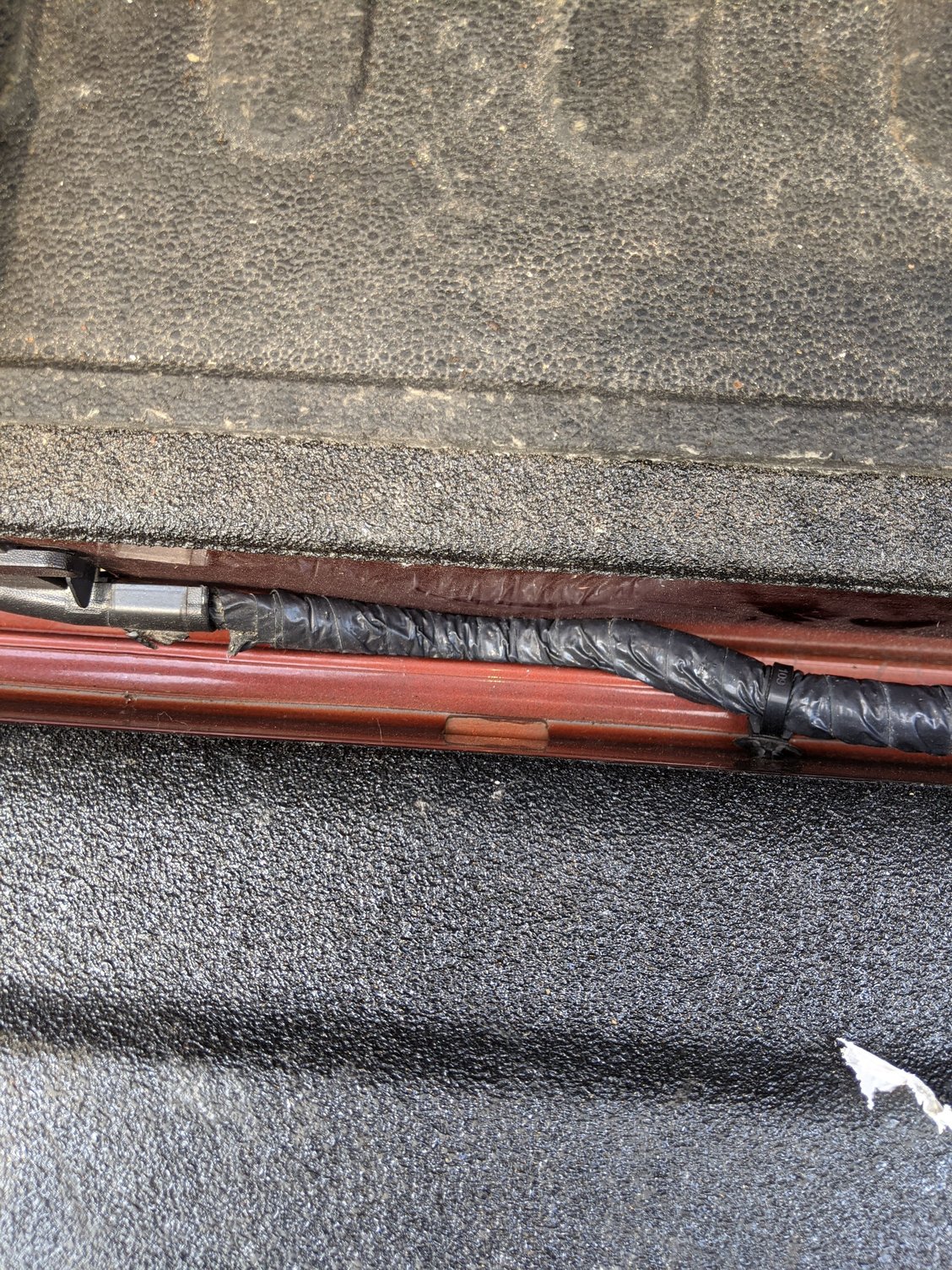

Old Aug 7, 2020 | 12:31 PM
  #39
RAMULAK's Avatar
RAMULAK
Posts: 716
From: Nashua, NH
I was having the same issue. Either black or a wobbly looking streaky image. Found out that pushing down on the wire that goes up into the tailgate and then shutting the gate fixed the problem for me. I'm assuming that the wire is getting pinched between the gate and the body. If you look, that wire bundle gets pulled through there and it is really tight. All you need is a rock or wood chip to get jammed in there and that cable is gonna be toast. They should bring that through in the tailgate sides where you won't be pinching it. Or make it Bluetooth to the head unit.
