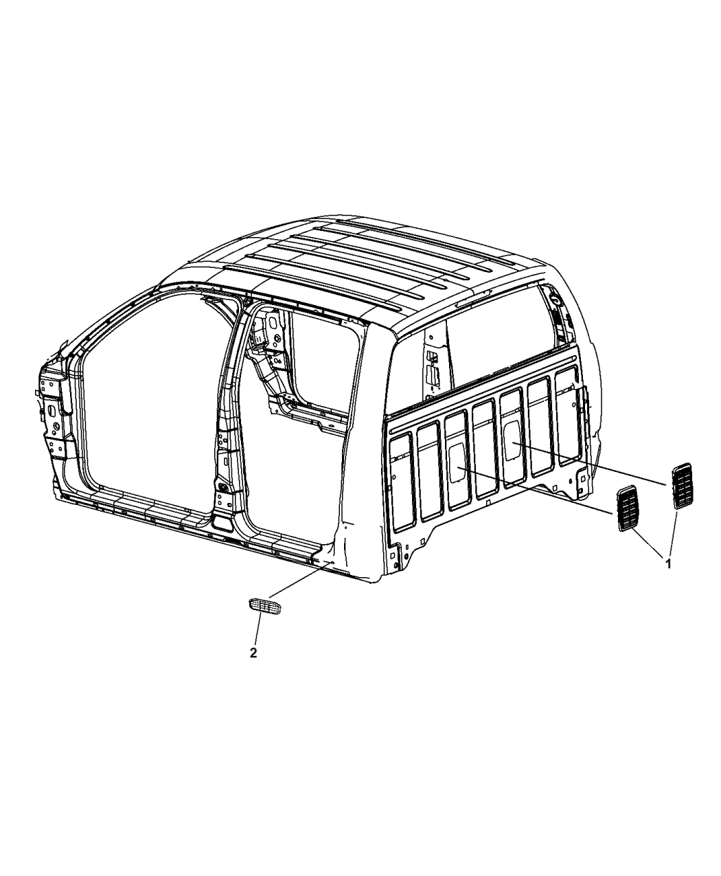

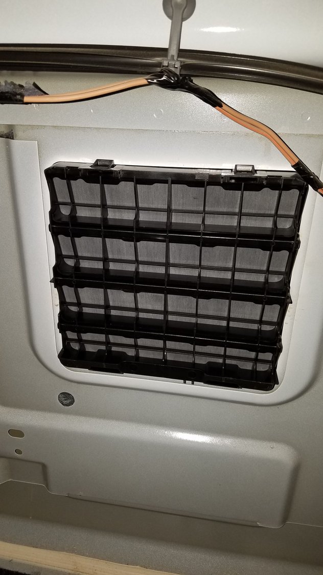

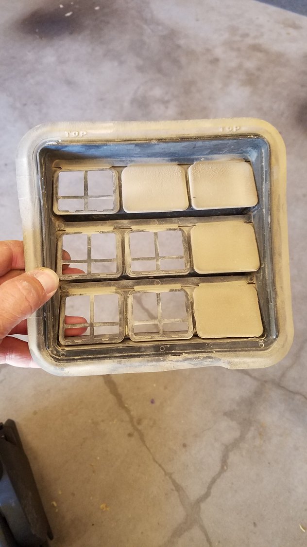

there are 2 vents in the back of the cab that let the pressure out when you close the doors, they have a rubber flap that is suppose to stay closed but it does not and it just lets dirt in the cab, a filter will do zero good. The box i am referring to is the bed of the truck.

Last edited by Dan15; Oct 21, 2019 at 12:58 PM. Reason: 1st picture is from left side of cab (not going to hold out dust when missing), second is right, third is new style. and yes

1st picture is from left side of cab (not going to hold out dust when missing), second is right, third is new style. and yes you can replace them without taking bed off. they were $7.00 each from the dealership.
