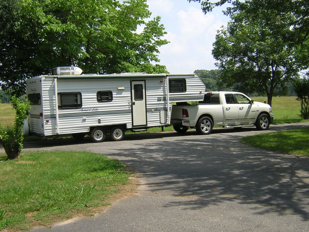

This trailer is between 4500 and 5000 lbs pounds. Not sure of tongue weight. Pulls great. Stops great. Enough power to accelerate even on pretty steep inclines. NO AIR BAGS. In fact I had wished for a little more 'sag' to level trailer out a bit more. Name:  09Dodgetruckand5thwheel003.jpg
