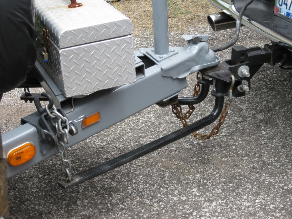

Weight distribution hitch should help
Oh yeah and if you don't already have one that would mostlikely solve it all. You could pretty much have those on and take ur rear tires off and the rear axle would stay off the ground.

The bags were a good start, but like others are saying, a WD hitch is gonna be needed to stabilize that ride while towing...

As for the toungue weight, they say between 7-10% tongue with boats and 10+% with travel/campers. I'm between 7-8% now and thinking if I put more on there its only going to make the jostling / trampoline effect worse. Boat trailer has surge breaks and a weight distribution hitch can be tricky with them, plus i'm not looking to spend another 400 to make this truck handle right. The bags stiffened things up and I like the extra 1" of ride height when loaded.

i had an 04 150 previously ... learned with that i needed a load equalizing hitch to haul my enclosed car trailer. to much tounge weight and also a lot of bobbing as you describe.
got 09 ram 1500, using load hitch rides decently in my opinion and extra power makes it a much nicer experience. i wasnt happy with sag even with load equalizing hitch so i put in the airbags (also for when i haul 1500-2k occasionally) and with bags at 35 its much better.
