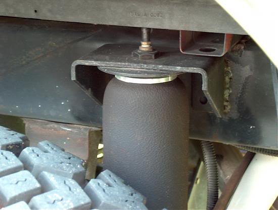

Yep, good old leaf spriings. I wanna say the model I have are the Ride Controls...
