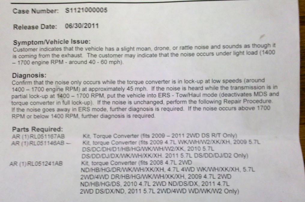

Star Case - Transmission noise - For those that are still looking for this info

There is a Star Case... https://dodgeforum.com/forum/attachm...1-37-20-am.jpg
Basically special instructions to dealers on how to treat a certain complaint.
I printed the photo, took in my truck and asked them to test for this, they have ordered the new torque converter, should be in soon.
